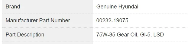

so i finally reached a local dealer who could find a part # for the LSD gear oil. 00232-19075 is what i was given. this is a different # than what others have posted - maybe it supersedes a previous #...dunno. they wanted $105 per bottle. found it online for $26 so i'll likely go that route if shipping is reasonable. otherwise i'll have to find a matching spec alternate like Redline.
seems to be the correct fluid, 75W85, GL-5 for LSD.

But this time with OEM oil part 00232-19075 75W 85 Gear Oil Gl 5 Lsd 00232-19075 | OEM Parts Online

Here what I've got from the dealer.

I replaced gear oil.
Vibration become worth.
After 150 miles vibration and grinding noise gone.
I would strongly recommend to use oil specified in the manual.
This fluid should be fine for an open diff '23 Sport Prestige 2.0T, right? Or does it also need to be 75/85? But no LSD additive needed, correct? Thx.
If you have LSD use ONLY 75/85.
No additive needed.
