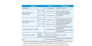

From your owner's manual (page 2-13):
Mine doesn't have LSD. Or at least it doesn't say on the window sticker, so doubt it has it, since it's a 4 banger. So which fluid for the non-LSD? Thx.
I would suggest whatever oil listed in manual. (see post above).
For not LSD differential it may be not so important, but it's better to follow a car manual.
I learned it by my mistake.
Quick Reference Guide sAttach fileshows only to inspect LSD oil. Very confusing.
