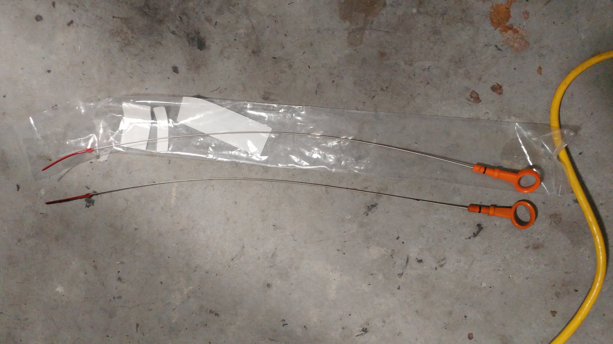

I ordered a 2018 G80 5.0 V8 new oil dipstick today from an online Hyundai/Genesis part website. The dipstick cost me $30 total with shipping. The 2015 and 2018 5.0 model dipstick part# is 26611-3F521
Therefore, I will assume that the dipstick was updated which affects the 2015-2018 model years. I will compare the original 2015 dipstick with the newer 2018 dipstick when my new dipstick arrives.
I decided to just buy a hopefully updated 2018 dipstick before my 2015 dipstick tip breaks.

I received my new dipstick and it seems the same as the old one except that the tip is more flexible on the new dip stick(almost like a zip-tie). The old tip flex also, but not as much as the new tip(bends a bit, but seems like it would break). I can see how the old tip will break when placed in the engine if pushed too hard since the oil dipstick tube does have a slight bend where it pushes back against the dipstick.
However, i do not know if the new dipstick uses a more flexible plastic tip or my old tip just got stiffer with age; yet is made out of the same material. Therefore, i will give feedback about if the new dipstick tip also become more rigid over time like the old one.
The new dip stick on top; the old dipstick below.

What you say could very well be true, however I feel better just paying only $25 for a new dipstick that seems to be more flexible to hopefully prevent the broken tip problem from ever happening in the first place.
Plus, I need to be able to check my oil level so I need a working dipstick since I do my own oil changes or a more reliable one.
