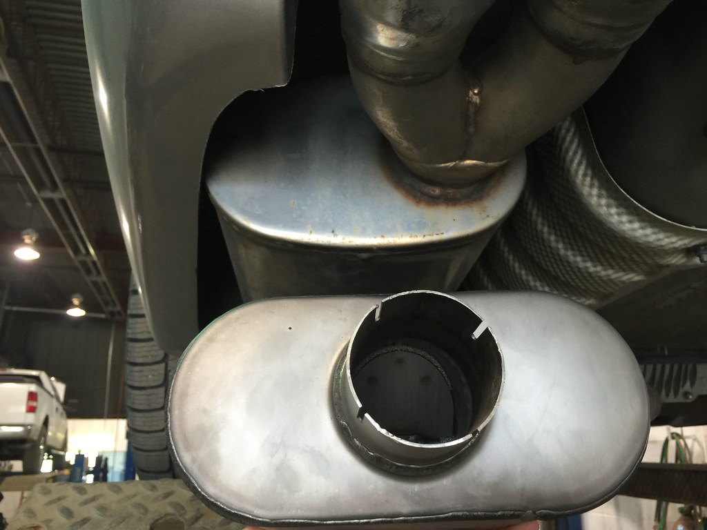

Pictures:
So, ran into a little bit of trouble with these. The OP is correct. The mufflers have to be installed at an angle as it is wider compared to the existing Magnaflow mufflers.
Due to the angle, I may not be able to keep the existing tips from the mufflers.

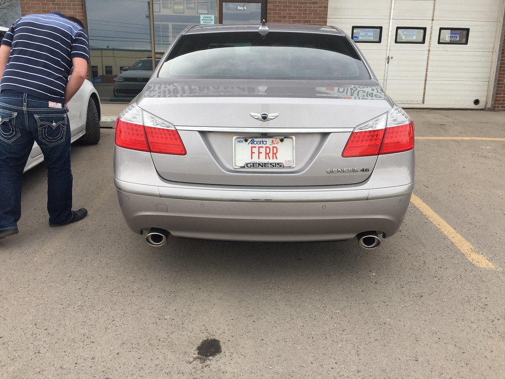

Wow! This was a quick update. Mufflers were successfully installed. The magnaflow tips were too long to install on the Dynomax so a separate tip is being used (Single tip).
No more quad tips. The quad tips from the Magnaflow were too long to fit on the Dynomax VTs. It would stick out way too much and look really off.
They had these on hand and it was the closest thing to looking stock so opted for these instead. Looks a little off but getting used to the look.
The tips are a FloPro ST062. The ST062 is a resonated exhaust tip the ST062N is a non-resonated tip. The resonated tip quiets the mufflers even more.
