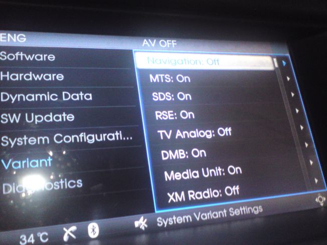

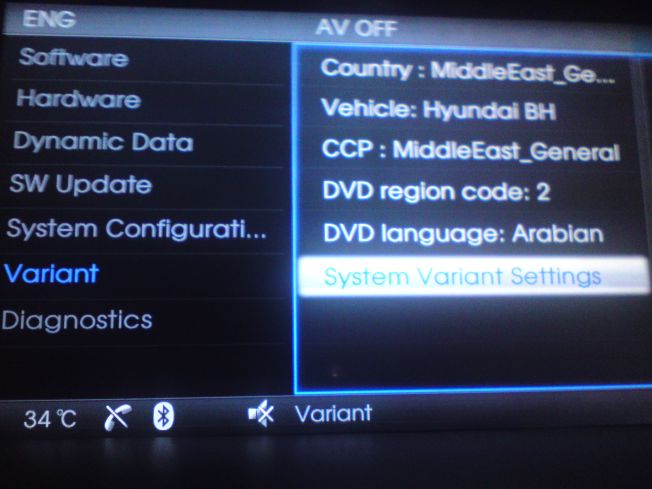

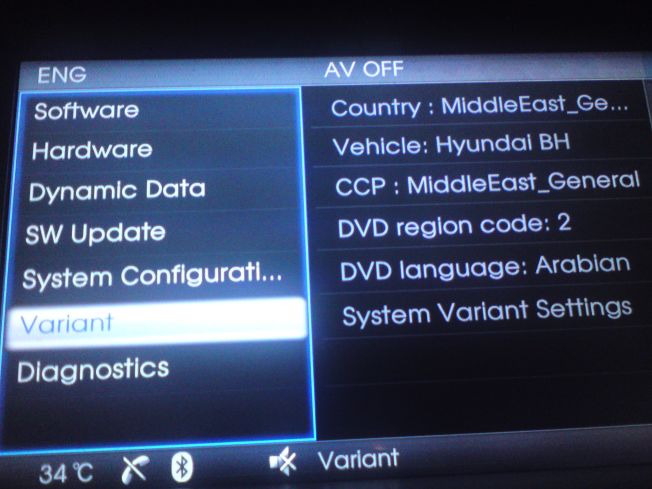

From the secret menu we were able to get the following info:

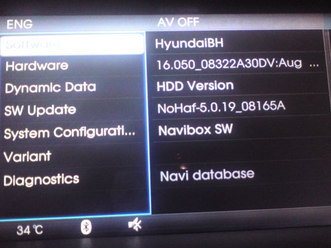

- The car is equipped with a hard drive.
- No Navigation Box software and no Navigation Maps.

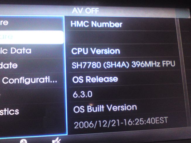

- OS Build version is very old, 2006!

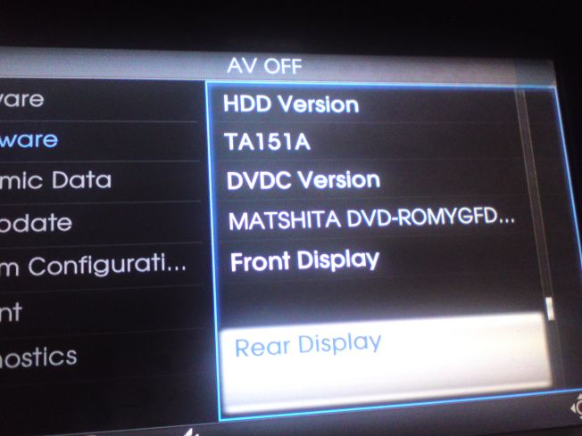

For the software, I read the thread talking about maps update, I’m not sure if those DVDs are compatible with ME HW version so I will post the HW version of the ME spec 2009 Genesis:
