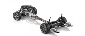

I took it to the dealer yesterday and the cost given $1763. I will request the old part and speak to the tech there to determine what the actual problem maybe. There’s only one set of u joints and I am wondering if that’s the issue? I am ordering the part myself which will save me $300 more. Just hoping with COVID-19 will receive the part in the time frame given. If all goes as planned who to have the car back end of next week.
I hope it all works out for you.
See attached image of undercarriage.
I do not know if this picture is totally accurate, but I think it is a good representation and helps give a visual.
Couldn’t see picture.
One more try,
