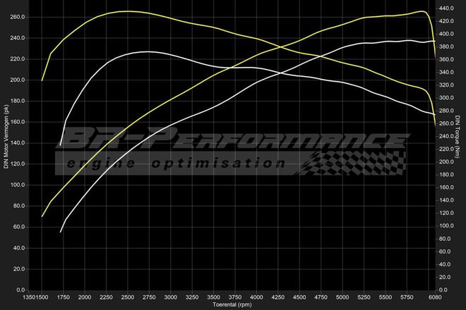

Dunno if this is what OP was referring to, but the 2.0T's torque band doesn't start until past 2000RPM. The 8AT deals with this easier. With a 6MT, you'll have to spool the RPM and slip the clutch a bit on launch to get past that sub 2000RPM lull. I might do that at AutoX, but it is rather pointless for everyday driving.
Realistically though, in our G70 6MT, I don't notice the soft spot down low in 1st gear, as it doesn't stay there for very long at all. And for daily driving, I'm more concerned about being smooth on clutch take up, than all out performance off the line. Don't short shift, and you'll never see it in 2nd gear and up.
