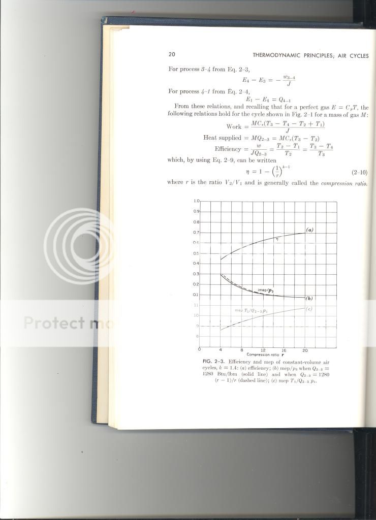

Higher compression engines are more efficient than lower compression engines regardless of the fuel they burn. It's because of the technical benefits of higher compression-----------not the fuel being burned.
Look at it this way:
If a 10:1 compression engine is 25% efficient, increasing the compression to 15:1 will perhaps make it 27% efficient (or whatever). That improvement will be irrelevant of whether ethanol or gasoline or some blend of the two is being used (as long as the octane is high enough to avoid detonation).
Btu's are Btu's.

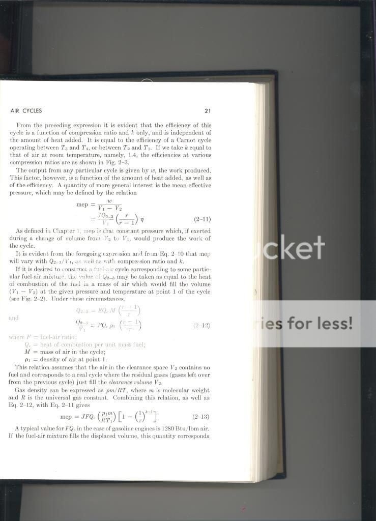

Here are a couple of pages from the Bible of engine design (Taylor and Taylor, The Internal Combustion Engine).
Please note the sentence on the image (page 21) that says, "From the preceding expression, it is evident that the efficiency of this cycle is a function of compression ratio and K only, and is independent of the amount of heat added."
The current edition of Taylor and Taylor is available on Amazon---------even after all the years since I was in engineering school. Let me know when you have purchased a copy and understand it.
Wow -- quotes from the bible of engine design -- and quotes from astronomer neil tyson -- that ought to convince 'em -- these authorities back up everything I say -- therefore REAL gas cannot possibly get better mileage than gas with water, er i mean ethanol in it.
No matter what my lying eyes see, just believe my words. I have authority to back me up -- and my voice is louder -- that helps too. If I can repeat this lie long enough, it will be true. And besides, I can find some more authorities........
How many college text books on engines do you have out? :)
Look at the last paragraph of the second page posted, "A typical value of FQ in the case of gasoline engines is 1280 Btu/lbm air."
That is GAS, you change the dynamic when you add ethanol/water
Again: Btu's are Btu's------whether from gas, ethanol, or some mixture of the two. A lbm of air will only allow so many Btu's of fuel to be burned. Those Btu's can come from any mixture of gas and ethanol.
Again: "From the preceding expression, it is evident that the efficiency of this cycle is a function of compression ratio and K only, and is independent of the amount of heat added."
