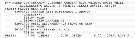

Confirmed with Terradude's pic

Called service, appointment set for 22nd… I brought new part number to their attention, so hopefully this is what I’ll end up getting.

My 22 2.5T Advanced goes in for its first 8k service, and will be checking out the whine noise between 45-55 MPH. I will enclose the replacement rear differential part number info supplied previously by an owner in this forum.

Just got the car back (took them 3 days to finally look at it, service sucks) and as expected, rear differential needs replacing. No word on when the part will come in but they say I can keep driving it until then. Should be a recall at this point based on all the people having this issue.
