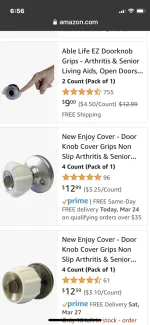

Regarding the infotainment control knob, has anybody tried this fix?
Is it broken? Mine works great...a simple spin...
