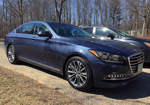

Brand new 2016 3.8 AWD with Tech Package. I've had it for three weeks and 8 of those days it's been in the shop. The Smart Cruise just keeps downshifting and downshifting and the brakes fight the engine to try to keep the car at a set speed while the RPMs dangerously rise. I cut it off at 4,500 RPM at 55 mph on level highway. It also jabs the brakes violently if you just tap the brake pedal to disengage the cruise when it's doing that.
They replaced one of the radar modules and the AEB braking module but it's still doing it. So tomorrow they are replacing the entire master cruise computer module. I so want this car to be fixed. I love everything about it, but that cruise control isn't just unusable, it's dangerous. Definitely not the wonderful experience I had hoped for when I got this car three weeks ago.
The New 2016 Genesis by Troy, on Flickr
I'm glad the rest of the car is working. The adaptive cruise control has been working well since the 2009 model so I'm sure it's one of those weird issues on your car but once it's fixed you should be good to go.
