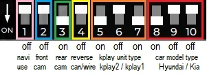

Kplay2 video interface dip switch settings for Genesis with CAN reverse detect.
Not sure what it is for as it was not mentioned in the installation instruction but It was not needed for my Installation.
