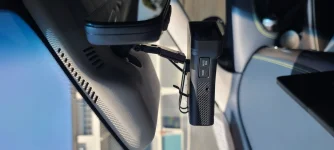

Here is my installation, works when the car is powered off and I walk away. Let me know if you have any questions!
Sweet TY! So you're not using fuse 2? And you're using a 5A fuse? Don't you need to use a 10A fuse to compliment the A/C? Sorry, I'm a total noob when it comes to fuses 😑
So both fuses are on the fuse tap thing, you just can't see it because of how the tap is designed, but it is under the yellow fuse that you can see.
The 5a yellow fuse that you can see is where the power splits to the dash cam, and under that is the original 10a fuse that is now placed in the fuse tap, and that the tap allows that power to redirect back into the car. So where the 5a fuse now is, if the power exceeds 5a, the fuse will break and stop the power from killing your dash cam, but the 10a functions as it did originally except it is re-routed through the tap thing now.
