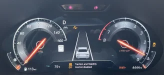

I have a 2022 G80 Sport and Launch Control works fine. Put it in Sport or Sport+ mode. Then hold down the traction control button for 3 seconds.
You will get a beep and cluster confirmation that they have been disabled.

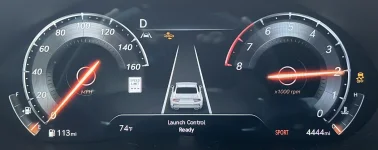

Fully hold down the brake, and then fully hold down the gas pedal. You will get visaul confirmation that Launch Control is ready as well as a beep.
Simply let go of the brake as quickly as possible and enjoy the ride. And don't worry about over-revving the engine... Launch Control actually does a great job of intelligently managing everything.
