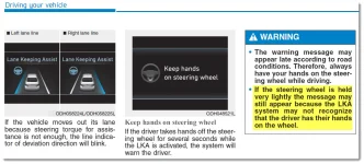

I think it's a sensor in the wheel itself, not triggered by movement. It sounds that way in the manual. They talk about touch, not movement.
2019 G80 manual (yellow highlighting was added by me):
2019 G80 manual:
Sounds that way but my experience is different. I've driven with gloves to avoid skin contact and get no alarm. Couple of weeks ago I drove about 20 miles and never put my hands on the wheel but gave it a nudge with cardboard every minute or so and no alarms. Just a half degree or less wheel movement kept if from alarming. I had no physical body contact during that time, a nice flat straight stretch at 50 mph.

Interesting indeed... in my experience, the alarm goes off when I have a light touch on the wheel.
What I don't know is how much movement is needed and if it can be adjusted. There have been a few complaints about it going off. Maybe a good road and a car tracking well is what does it. Would be nice if the dealer can adjust the overly sensitive though.
