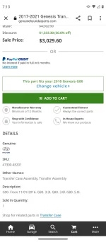

I looked it up and my transfer case part number is 47300-4E201, and it says that it's the same one across all G80 after 11/01/2016, it's also the same as the G90, yet not the G70, I guess little brother has a smaller one?

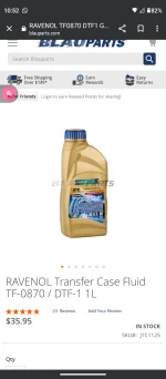

I "changed" the Transfer Case fluid on my Genesis G80 Sport 3.3 HTRAC Dec 7, 2022.. Car had ~57,600 miles on it I used the Ravenol Transfer Fluid DTF-1.

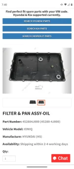

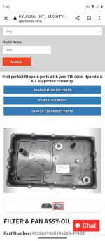

Hi guys, which trans pan is the one for the G80 sport, because these two are different one has one pickup line going out of the filter and the other got two.

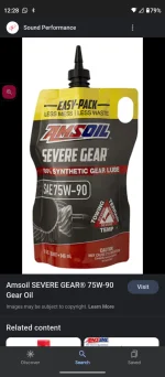

I just did the front and rear differentials, transfer case, and transmission fluids on my 2018 Genesis G80 sport AWD.
I uploaded pictures of all the fluids that I used, but if you want an even more luxuries ride use amsoil 75w-110 diff fluid.

I used the OEM Genesis transfer case fluid; see attached image.
Looks expensive lol. But it's the same stuff that I used. TF-0870. I used to have a slight Whining noise when going full throttle, and after the fluid change it's gone.
