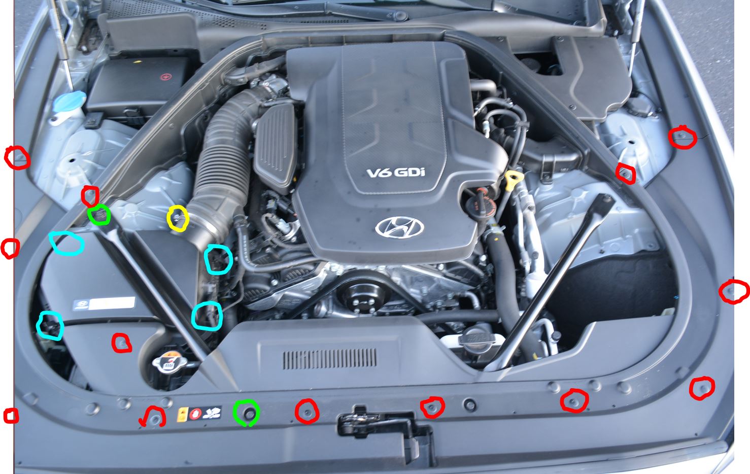

In order - do the following:
Push in the center of all the plastic pins (red). They will pop in - then you can fish them out of their holes. Don't lose any. They are all the same size - so mix & match is fine.
Once those are removed - carefully separate the front black plastic cowling from rest near the shock towers. Once separated - tip the back up and slide towards the rear of the engine bay - this will remove the tongue portion of the cowling from the grooves in the nose. Set the cowling aside on the ground.
Loosen the two bolts for the subframe connector (green). Remove this bar - but take note of it's orientation. It only fits one way.
Unscrew the hose clamp (yellow) and give it plenty of slack.
Unclip the air filter box (blue). Lift up and jiggle it around a bit to get it to separate and come off the lower portion of the box. The filter will go with the cover. BE SURE not to pull the cover away as there is a cable attached. Flip the lid over in it's place and set it on top of the intake hose so it is out of the way.
Now you can use a ratchet with a long extension and a swivel on the end with a short, 8mm socket. Reach your right hand down and around the side of the lower air box to guide & stabilize the socket onto the adjustment bolt - which you will have in your left hand and feed down along the fender well.
Re-assemble in reverse. Don't forget to tighten the hose clamp on the intake duct. Also - to re-use the pins push the centers up so they protrude above the rest of the surface of the pin - push into hole, then push down the center so it is flush.
That's it.
