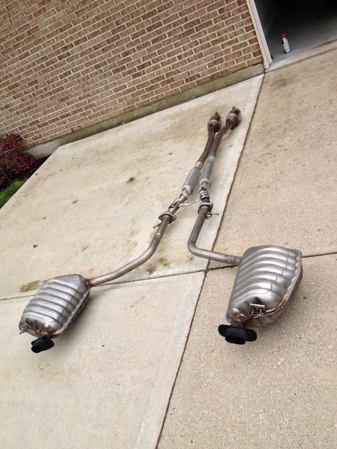

Here's the beast stock system with cats attached (removed all at once). Weighs a ton compared to the Magnaflow.

Received my exhaust yesterday and installed it today. Pretty easy to do, about 2 hours total taking my time and getting it perfect. Wish my MSA deletes had been here so I could install it all together. Sounds good, not near as loud as I thought it would be. I weighed both the factory and MF system, MF is 19.2lbs lighter. Looking at the two exhausts side by side, one would think the MF is 100lbs lighter!!
