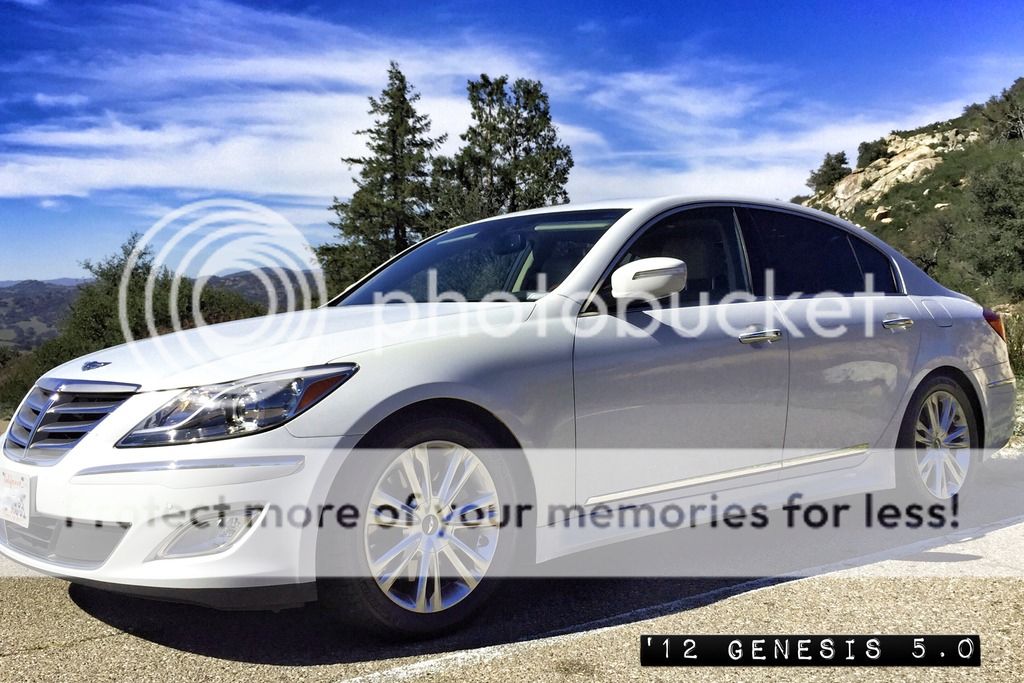

Sunday I spent 7 hours buffing my Car with Chemical Guys products and great results. I have used Meguiars and Wolfgang but CG stuff works great and easier to deal with. Here in Northeast Ohio my car get pretty scratch up during the winter.
- Clay Bar
- V36 with Orange Pad
- V38 with White Pad
- Black Light with Black Pad
- Jet Seal, 2 coats by hand
It looks great now I have to do my wife's Sorento(Black too) but I also just ordered the CG Butter Wet Wax for in-between wax coats.

DAMN that looks nice (both the wax job and the mods)
Thanks, lots of work but Black on Black looks great when super clean.
