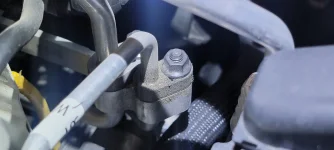

Was seeing if anyone here had any updates on this? My wife's GV70 bought July 4th 2021 in Houston TX is having the same problem blowing hot on driver side, dealership said probably the evaporator but I found a connection I believe is leaking because it has dirt built up on it like it's been leaking. Maybe it's both leaking and Evap idk we'll see.
Yes, that looks like a small leak.
