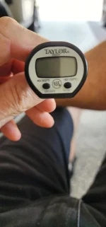

If you have an instant meat thermometer you can set it on the vent and get a good temp reading.
