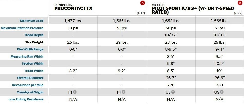

Michelin Pilot Sport A/S: 8.5", 10"

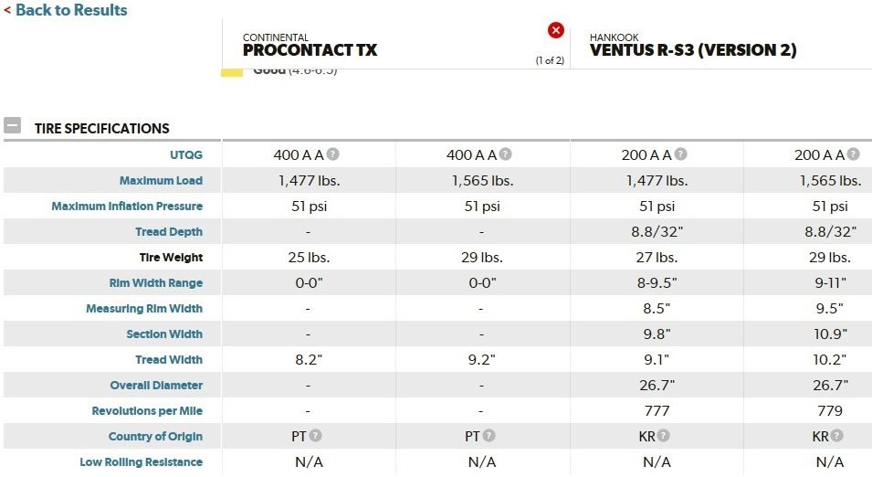

Here is a snap shot from Tire Rack comparing the Contis to the nearest Hankook to what we had on our cars. Where my car is parked at work I can cleary see a big difference in the width of the tire compared to what was on the car. These tires are at least an 1" narrower than the Hankooks that were on the car. I am also noticing that the flat spotting is much worse (more pronounced than the Hankook's were. It still goes away after a short period of time but in 70-80 degree weather, the Hankooks were smoother.
Here is a comparison to the Michelin Pilot Sport A/S 3's:
You are not comparing the correct tires as the new Ventus is totally redesigned and yes the tread is much wider than the norm on those.
Check out the spec on this tire which Hankook Ventus S1 Noble 2 as originally found on our car. Still a 275 however this is a 40 and not 35 like the discontinued model. As you can see, the tread width is 9.4 which is almost the same as the Continentals. http://www.tirerack.com/tires/tires...ewall=Blackwall&partnum=74WR9H452XL&tab=Specs
