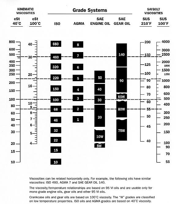

Maybe this will help
Where did you come up with piece of BS?
BTW:
  • Hyundai recommends 5W-20 for the Genesis
  • It Mobil 1, not Mobile 1
