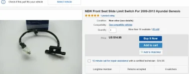

Having the same issue on my '11 Genesis. It looks like this is the Part # and only around $17 88533-3M900
Just pushed on the switch and it clicked and now seat works properly. Access from rear floor. Switch is about half way up on right hand side.

On Equus models the "switch" is actually on the left side of the seat if you are attempting to go under the seat from the rear. If you read previous post it indicates the right side from the rear for Genesis.
Equus = Left Side of Seat
Gensis = Right Side of Seat
