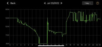

I've attached a few screen caps from my battery monitor to illustrate.
The July one was (I believe) my least dead battery. You can see that the battery went from 13V to 8V in just six hours. No trickle charger would help there.

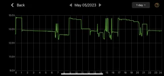

Here's the narrative on the screen cap from yesterday - a particularly interesting one given the activity during the day.
  • The battery got down to 12.65V before the system automatically topped it up just after midnight. It delivered voltage of ~14.7V while charging and brought the battery up to 12.95V when it was done.
  • The ups and downs from 6:30-7:00 are while I was driving and should probably be ignored as they were likely driven by different systems going on and off while driving. I arrived at the office and plugged the car in, but scheduled a delayed charge.
  • The car begins to charge the HV battery just before 9AM. The 12V battery reaches a low of 12.6V before it also begins charging simultaneously at 9AM. Charging voltage goes from 14.6V to 14.4V before stopping just before 11AM.
  • The HV battery continues charging until about 12:15, where we see that dip in voltage, then is flat at 12.9V until 1:30 when I leave the office. It rests at 12.8V while at home for a short while, dips down to 12.3V as I leave the trunk open while loading up the car.
  • Again, reported voltage swings up and down while driving ~2:45- 3:15.
  • There are some ups and downs at 12.3V to 12.6V as I leave the trunk open while unloading the car. Then remains about 12.8V for about an hour while the car is shut off.
  • Voltage goes from 14.4 to 14.1V from 5-8 PM while I'm using V2L. Then is at 13.7 on the drive back home, then remains at 12.9V for the rest of the night while shut off.
Over the course of the day, we see the battery charging spontaneously between 12-1AM, while charging the HV battery 9 - 11AM, while V2L is in use 5-8PM, and while driving ~9-9:30.

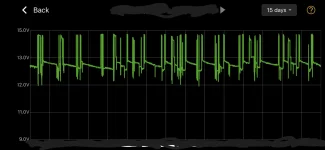

Finally, a 15 day graph (the longest period available). The car charges the battery whenever it hits 12.6V. Whenever the voltage appears lower, the car is in use. I wonder if that is a sign of a weak battery - from the three discharges it has suffered.
Does anyone see anything here that would indicate that a monthly trickle charge would be beneficial?
