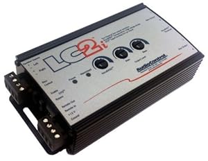

Added the LC2i from AudioControl along with the subwoofer level control. This has signal sensing turn on for the amp.

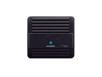

Added a Alpine MRP-M500 - Amplifier - 1-channel
Product Features
RMS Power Per Channel Into 4 Ohms: 300W X 1
RMS Power Per Channel Into 2 Ohms: 500W X 1
2 Single Voice Coil Subs Or 1 Dual Voice Coil Works Best
Number 1 Rated Amp In The US
Charles, How is the LC2i? I currently have a passive loc but was looking to switch to an active one since I feel the post processed signal is robbing me of the lower frequencies. My box was designed to hit 33hz and I am not getting anywhere close to that frequency response.

I'm interested in the LC2i because supposedly that thing restores the frequencies that were processed out. Allegedly.

There is no way to "restore" frequencies that were processed out. The LC2i does, however, have the ability to boost the existing low frequencies in the signal as the overall volume of the system is raised to correct for some factory systems that begin to limit low frequency output at higher volumes. Again, from my reading on the forum I don't believe this is an issue with the Genesis but hopefully someone will correct me if I'm wrong.

If your amp doesn't support speaker-level inputs then you'll need some sort of line out converter (LOC). Assuming I was correct in my last post and the "AccuBass" feature of the LC2i isn't really needed in a Genesis then you can find simpler LOCs for a good deal less money. On the other hand, the LC2i seems to have generally good reviews in terms of build quality and reliability.
Today I had my passive loc replaced with a LC2i and the results are night and day. I set my gains with a dd1 and before with the passive loc, it wouldn't detect distortion even with the gains on the amp and loc all the way up because of the low signal strength. With the LC2i, the signal strength was strong enough for the the loc gain to be set to 3/4 and the amp to be set at 1/4. Overall spl was significantly higher and the frequencies once not being passed through due to low signal strength were definitely being reproduced.
Charles, how did you calibrate the LC2i? Where did you set the accubass threshold? What volume did you find the stock unit stops upping the bass?
The way I have the LC2i set, the bass is fine at volume 8 and up but at 7 and below it sounds like my 12" isn't on. I don't think I have it set up correctly.

The LC2i is AWESOME! I added mine in today with a Kenwood Execelon 600/1 amp and a JL Audio 10w6 V3. The only thing I haven't found yet is a amplifer turn on so I am using the sensing now. I researched AllData, Directed Electronics dealer database, as well as googling to death but with any of the stuff it mentioned, nothing matched at all. I have the 2012 R=Spec with the Lexicon 17 speaker system, anyone else ever found the amp turn on?
Also, to answer an above question, I tapped my LC2i off of both of the sub inputs. So far playing a good variety of music, I haven't heard any areas where it seems to be missing anything. I will run some sine sweeps tomorrow to check fully.

On your LC2i, are you using the sensing circuit to turn on the amp or a direct turn on feed?
I'm using the sensing circuit. So far it hasn't had any issues.
