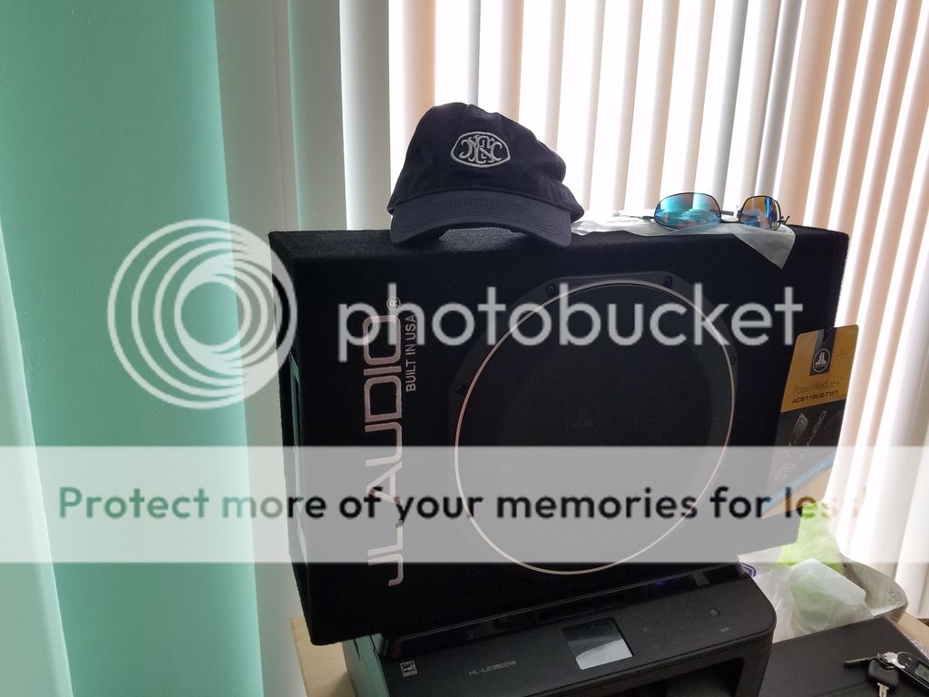

I promised myself I wouldn't screw with the audio, and as full and rich and buzzword and so on, I like some punch in the low end, so I'm gonna put on my stylin FNH hat and my Oakley's I just put some kick ass Swiss lenses in and take the .338 to the range, now THAT is some low end punch. Oh yeah, got a sub today too.
Nice! That's the same sub (10"?) I'm aiming to get too. I'm still doing more research to prepare for the purchase and the install. Let us know how it goes...install and post install results. Good luck!
EDIT... Doh! I see it's a 12" after zooming in. Very NICE! For me, the 10" will be plenty from my experience with the JLA enclosed sub in my old Camry.
