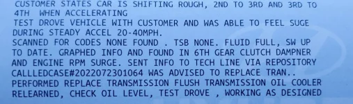

Took the service tech with me for a drive, he felt it, but is hesitant to start troubleshooting with replacing the solenoids, etc...because there was no DTC.....dealer quoted me $1400 for the TSB as I'm out of warranty, problem could get real serious if this leads to larger trans problems.
I still suggest you start by replacing the fluid and the pan first. If the problem persists then go for changing the solenoids at a certified dealer or a good workshop.

I have a 2017 G80 5.0 with 85,000 miles on it. I'm the original owner. It started the dreaded jerk around 65,000 miles. I have taken it to rhe Genesis dealer here in Alabama (before they closed) and the issue could never be replicated by tech. Had the transmission serviced, and it helped a little but it ultimately got worse again over time. Now with 85,000 miles and my power train warranty expiring at 100,000 I had it looked at by the local Hyundai dealership. The tech was in total disbelief that I had been driving with this issue. They told me that because it was a 2017 they can still work on it. It would jerk so hard that I thought it was about to break apart. Since I was the original owner, they submitted the paperwork and it was covered under the power train warranty. They had it for about two weeks and I just got it back today. I had a few other things done ( brake flush and alignment) and she drive like she's brand new again. This is my third Genesis. I had the 2009, 2013 and the 2017. I love the styling and the way the drive. I agree with everyone the Genesis service does need to be better.
