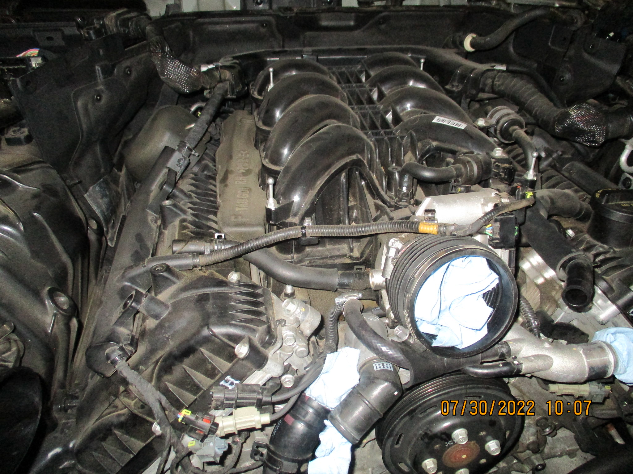

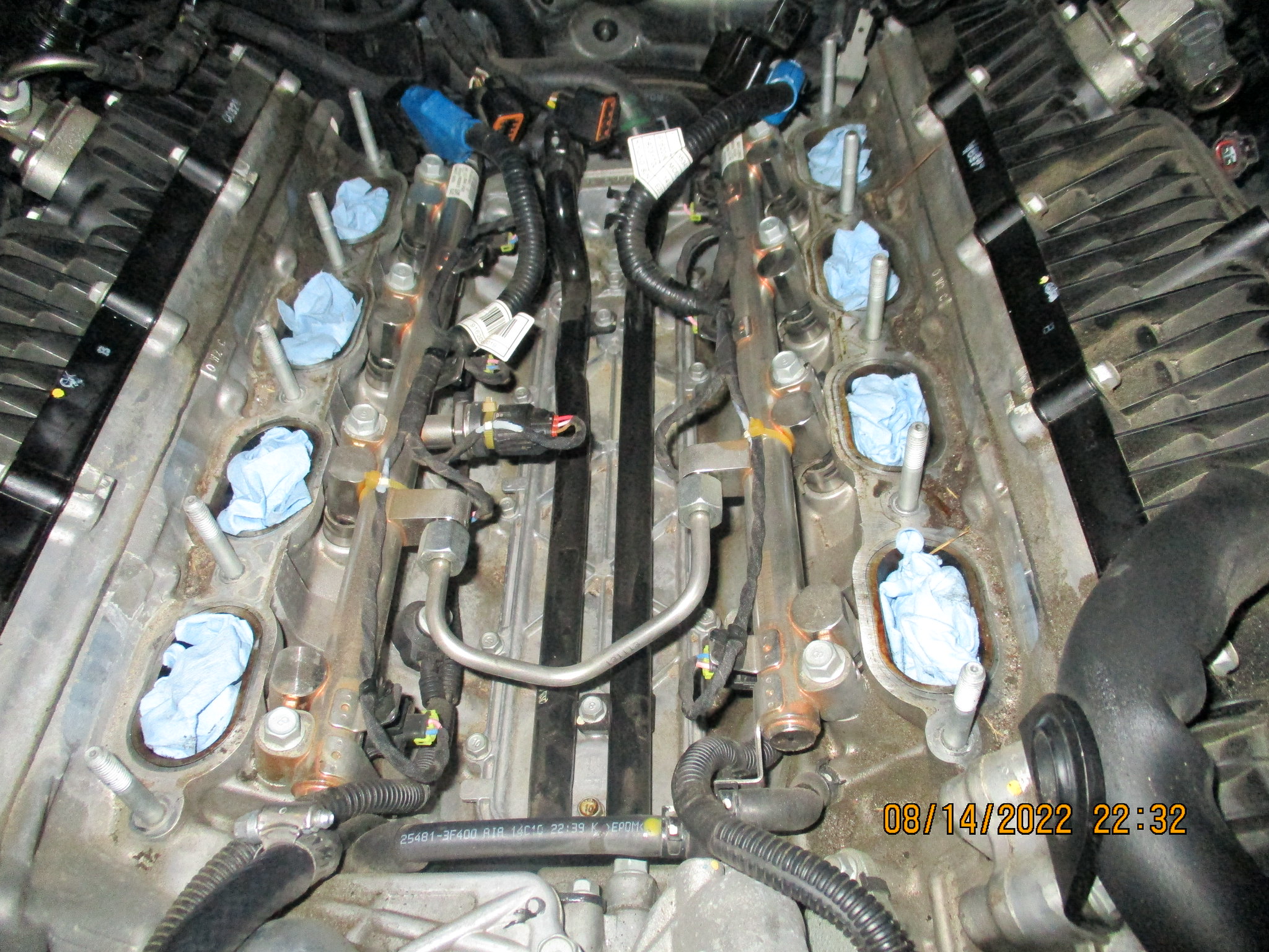

Which engine do you have?
On the 3.8, the fuel rails (including direct injectors) have to be removed to get to the oil pressure sensor. It also looks like you have to modify a wrench to get to it without also removing a coolant line.
View of oil pressure sensor (and modified wrench) after manifold and fuel rails removed.
