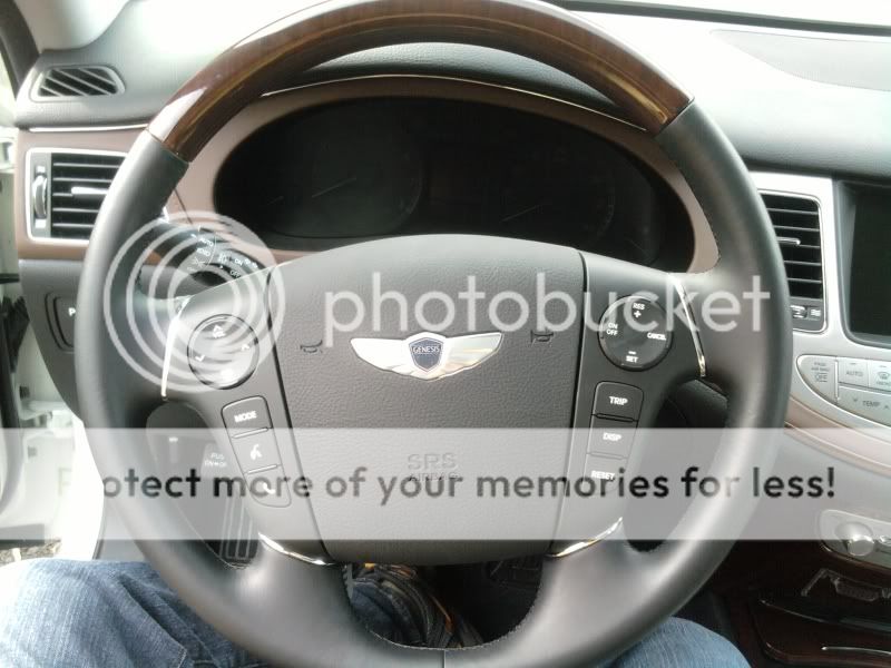

Just replaced the original airbag with the "winged" version. It was a snap and only took 10 minutes. My dealer said they would have charged $100! I would never have had he nerve to try it without the very heplfull photos from the original poster (ASHDUMP) and with the advice and encouragement of MHT. Thank you all!!!! Bob Burgess

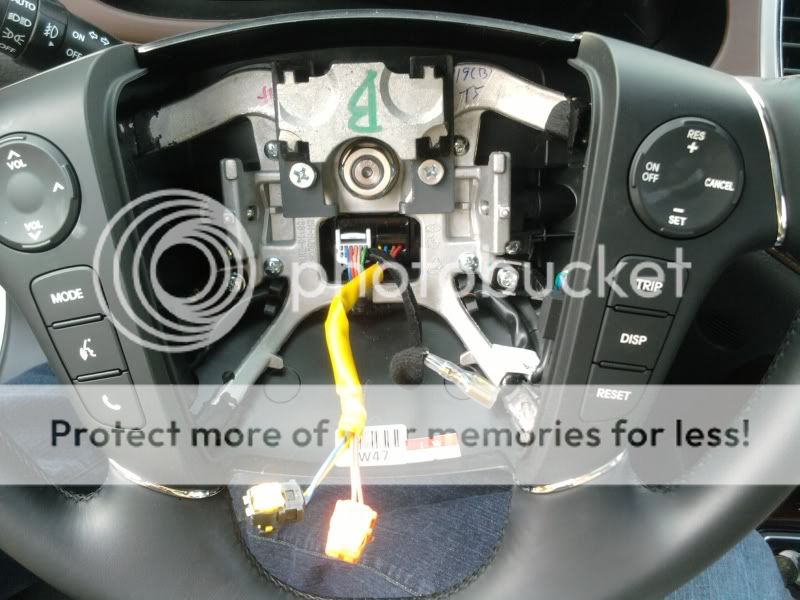

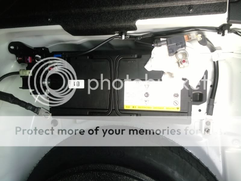

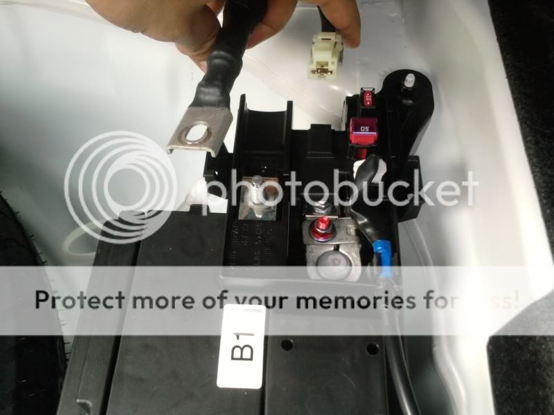

I installed the airbag today. It was extreamly easy and would have to say the hardest part was disconnecting the battery. Only because I didn't feel like taking out the rubber trunk mat and was bending over while it was on top of my head!

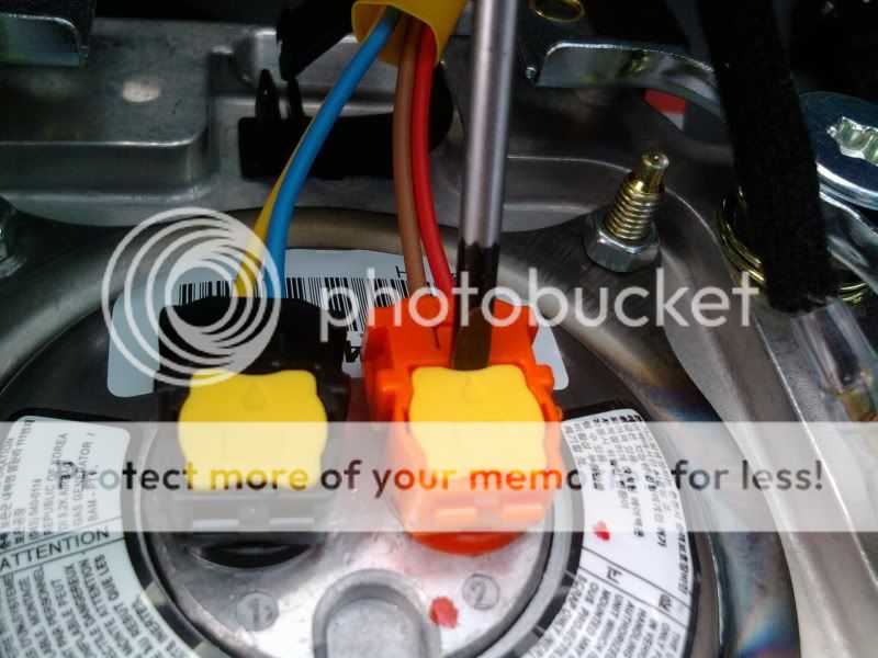

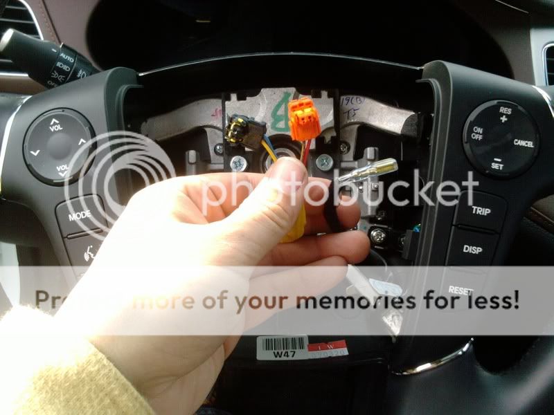

1. Disconnect the battery. I had to put a ball of paper towels under the (-) terminal because there was no slack for it to stay away from the battery.

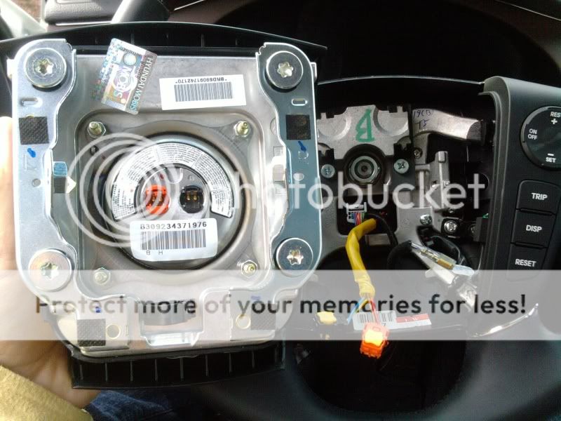

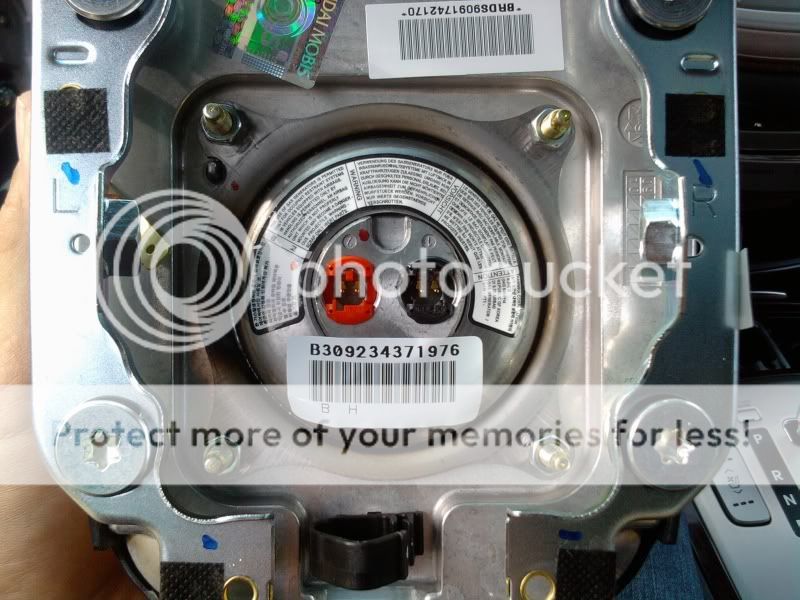

2. Unscrew the two (star) screws on either side of the steering wheel.

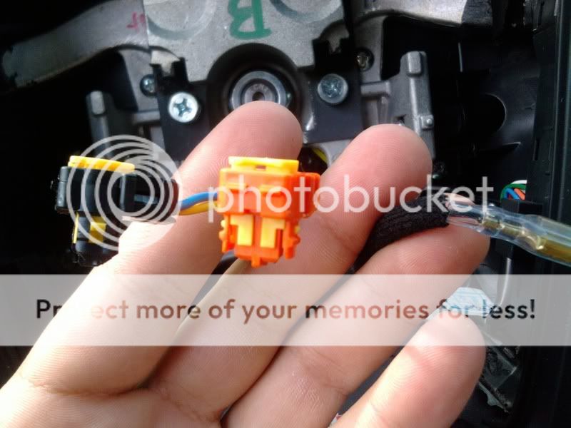

3. Pull SRS towards you and look behind to see whats going on.
4. Disconnect the ground and the 2 black and red plugs. This is where using a very small flat head will come in handy. You need to pop the yellow clips upward to release the plugs.
5. Now the SRS is completely disconnected.
[/URL]

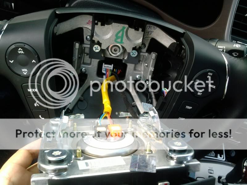

6. Now follow all the steps in reverse to put the new winged badge SRS airbag on and enjoy.
*Please remember that you are doing this at your own risk. I am not responsible for anyone or any product you purchase. Also keep in mind that this was how I installed my SRS airbag. You may choose to do so differently.
Also remember to follow the instruction in the Hyundai manual for disconnecting the battery.

Thanks to all forum contributors I have installed the Winged SRS correctly and have had to preform no resets. This was my last badge modification.
