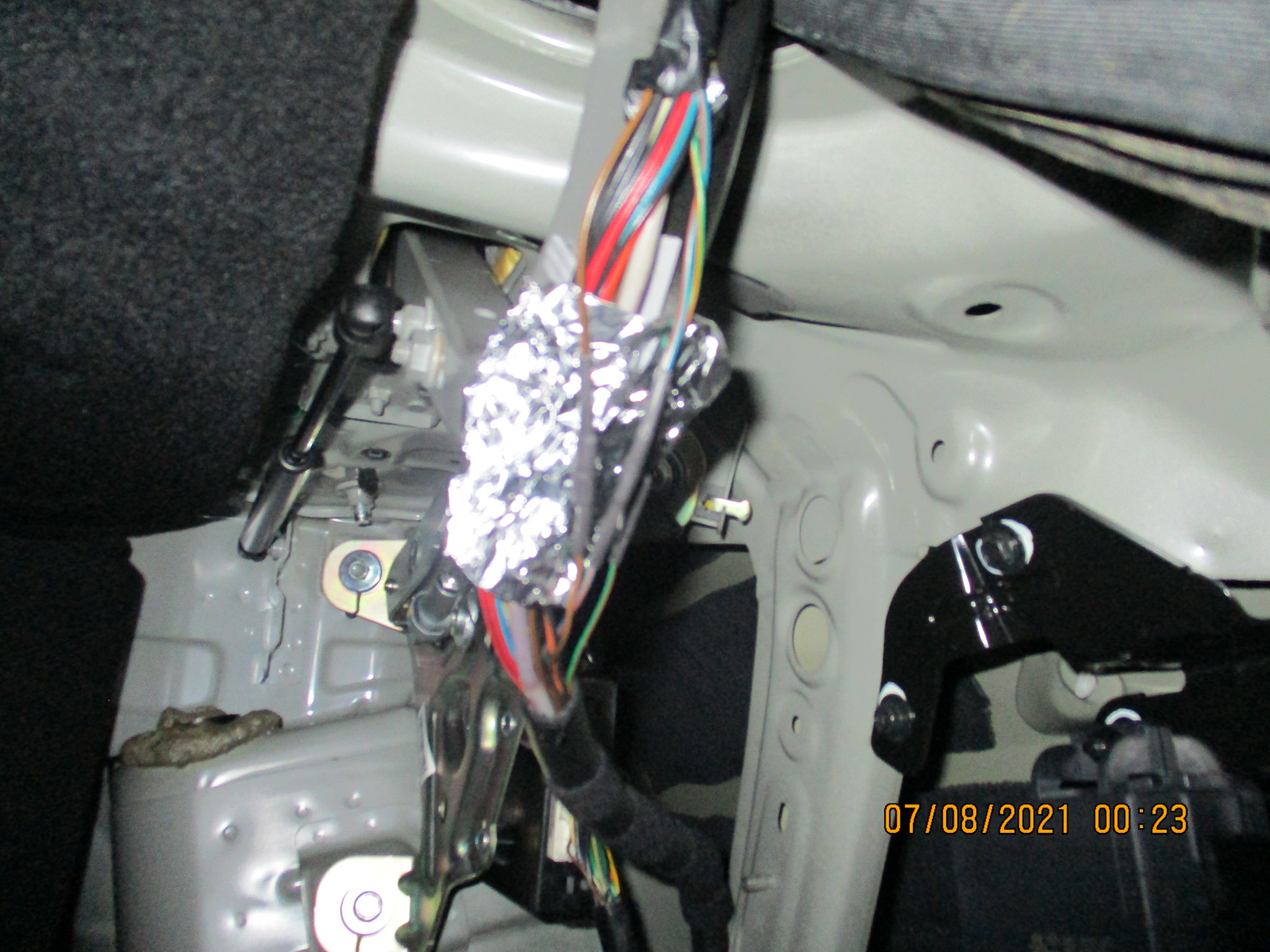

You should relocate the wire harness so the issue will not happen again if you fixed the wires already. The wires harness is on a bracket that is too close to the hinge which puts too much stress on the wiring harness when the trunk opens and closes. The wires break over time and disable the inner taillight usually, however other wires are in the harness as well so something else can be affected also.
The solution is to remove the wire harness support tab from the metal bracket(remove metal bracket as well) and place the tab in the oval shaped hole in the chassis a bit lower than where the metal bracket was located. The location gives the wire harness more slack to prevent the wires from being overly stressed when the trunk moves.
I had the same issue recently. Here is my fix.
Yeah I already fixed mine. But I wasn’t going to go through all of that again in the future so I went ahead and spliced and added wire to every single wire at the weak point. About 8 inches in length and a little thicker I think it was 18 gauge. It has pretty much the same set up on the driver side but I didn’t mess with that side. I’ll just keep my fingers crossed for that side.
