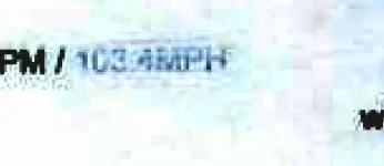

However, to get to the meat of the issue, I find some of these results to be suspect and maybe open to interpretation, due to several inconsistencies with these reports:
1 – Some members may know that for a Mustang Dyno, it is absolutely crucial to enter the correct vehicle weight, in these particular tests, the number that was used is off by as much as 900+ pounds (correct weight should be 4588 pounds + the driver), which may explain the abysmal HP numbers noted by all three tests.
2 – You went to great lengths to try to hide the measured MPH for MAX TRQ and HP for all three tests (after / for each TRQ and HP numbers)! Why? :(
Fortunately for others that I care about on this forum, I have ways…
So I found out that for test 2 and 3 the speed was around 103 MPH which tells me you where in 4th gear for these tests, however for test 1 the speed was around 88 MPH which tells me you were in third gear!
Right there could explain the magical gains noted between test 1 and tests 2 & 3.
Next on the menu; the Mustang Dyno manual clearly states that measurements should be taken with the closest 1:1 ratio gear, which for the Genesis 8sp is actually the 5th gear, should one wishes to get some proper readings!
http://www.mustangdyne.com/mustangd...uploads/downloads/2011/11/QuickStartGuide.pdf
3 – But wait! Look at the 10 degree temperature reading differences I hear you say?
Well from your web site I see you have a fancy AWD Mustang Dyno which undoubtedly has an equally impressive variable exhaust fan(s) connected to the ‘Stag’? If so, I am wondering what effect the exhaust fan speed would have between 88mph and 103mph simulated wind speed at the same RPMs?
Around 10 Degrees or so, I would hasten to guess?

As for the dyno results, or dyno does not lie. We are bonded and do testing for BMW, Volvo, Porsche and Audi when the cars reach Ventura Harbor. Our dyno is calibrated every 30 days and certified every 90 by Mustang Dyne as well as independent 3rd parties when it is called for.

The only info removed from the dyno sheets was customer privacy stuff. Nothing germane to the figures was redacted. Not sure what ways you have of reading mph but I can tell you all runs were made in 1:1 5th gear not 3rd or 4th. The car made peak hp at 123 mph and torque at 104.
You lost me on the exhaust fan summation. It had no bearing and again all testing was done the same way and I front of the customer.
I hope I was able to understand the flaws in your theory. I am not hear to fight. I was trying to help the guy out. Good luck everyone. Its a nice car
