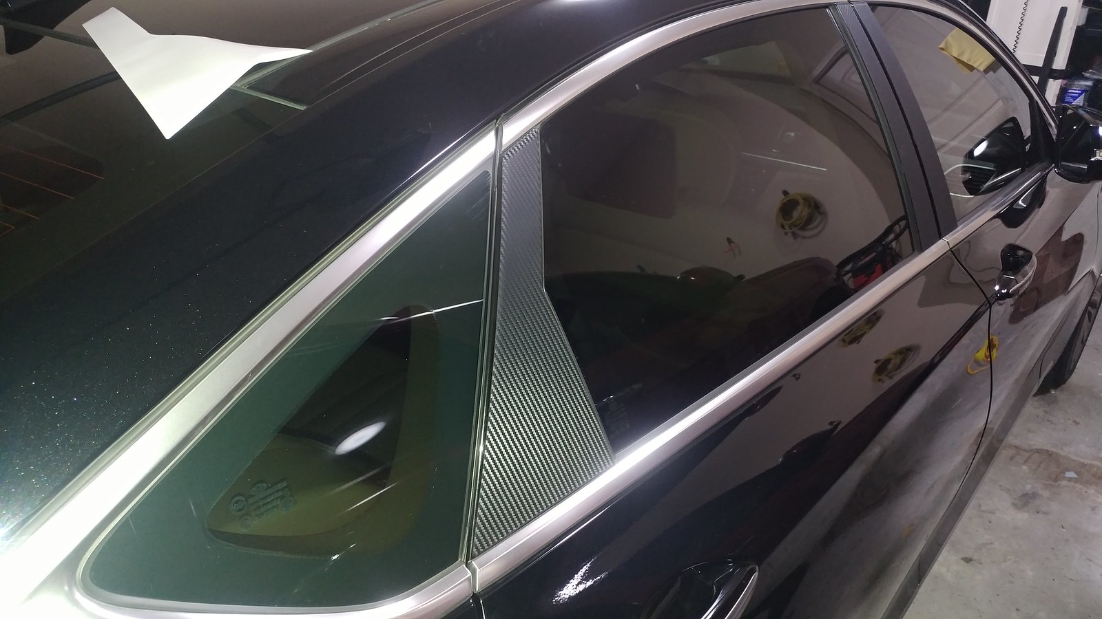

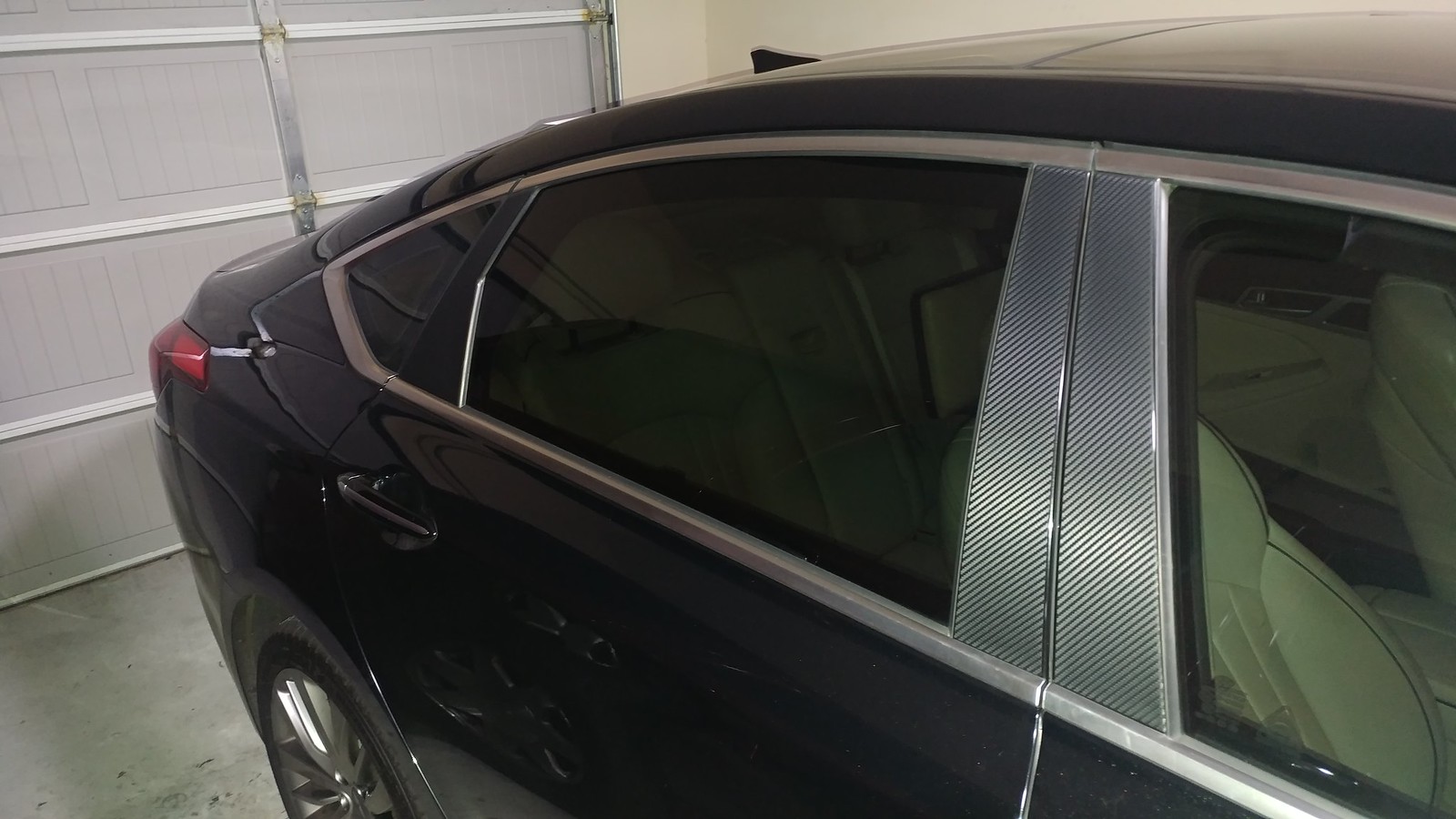

I added some black Di Noc Carbon Fiber pillar trim covers to my Genesis to cover the scratched and worn OEM piano black pillars. The last owner did not do a great job on protecting the exterior. I also have to buff out a lot of fine scratches in the paint. Nothing deep, but noticeable after a good washing.
I like the Di Noc material since it holds up well for years. I had some installed on my old 2004 Infiniti FX45 and it covered the faded pillars perfectly until I traded it 3 years after installing them.
The carbon fiber pillars look like a textured black design unless in direct light then it looks like real carbon fiber.

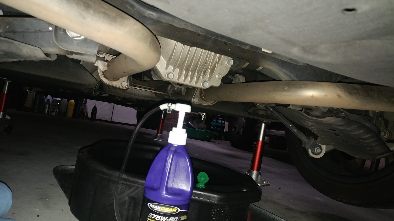

Today I did a drain-and-fill on my rear differential. Very easy on this car. I used Royal Purple 75w-90 gear oil.
My car is close to 60k miles , so decided to just drain the old fluid. The old fluid still seem good, however it was dark and the drain bolt magnet had some fine metal sludge on it. Most likely from the break-end period. Usually drive-train parts makes the most metal debris during break-end, hence why I usually change my fluid early the first time on cars I plan to keep for a while.
The drain and fill bolts are both 24mm bolts. My advice would be to level the car so that you will get an accurate fluid drain and filling level. I used four jack stands and a cross beam attachment on my floor jack to easily jack up one side at a time and then sit the car level on jack stands.
Tip: Always remove your fill bolt before draining your fluid just in case you have seized fill bolt. There nothing more frustrating than draining your fluid and then you can not fill it back up if the fill bolt is stuck. I learn that the hard way on a older Mercedes V8.:)
The Genesis up on jack stands.
The drain bolt removed.
The fill bolt removed.

Today I did a drain-and-fill on my rear differential. Very easy on this car. I used Royal Purple 75-90 gear oil.
My car is close to 60k miles , so decided to just drain the old fluid. The old fluid still seem good, however it was dark and the magnet had some fine metal sludge on it. Most likely from the break-end period. Usually drivetrain parts makes the most metal debris during break-end, hence why I usually change my fluid early the first time on cars I plan to keep for a while.
The drain and fill bolts are both bolts 24mm. My advice would be to level the car so that you will get an accurate fluid drain and filling level. I used for jack stands and a cross beam attachment on my floor jack to easily jack up one side at a time and then sit the car level on jack stands.
Feel any different? Anyone know what kind of diff is in out cars? Wondering if redline shockproof might work better vs RP maxgear?
I have not tested today, but I only use RP gear oil in my rides. Mostly because they are easy to find locally as well as online.
Redline seem like it would be the better performing gear oil based on reputation, but I am cool with RP performance.
We have just a standard open differential, no mechanical limited slip unit. The brakes are used to control wheel slippage.
Cool, was told a while a go to use redline shockproof for torsen style mech diffs, clutch style use RP or something of that nature.
Sounds about right. However, it seems that many high performance owners seems to prefer Redline fluid regardless of the differential design. RP and Motul fluid seems to be the next preferred choice then follows Mobil1, Valvoline, etc. Well, at least on some German cars I used to own. I just use RP by default unless the rear differential need some special friction modifier added to the fluid.
