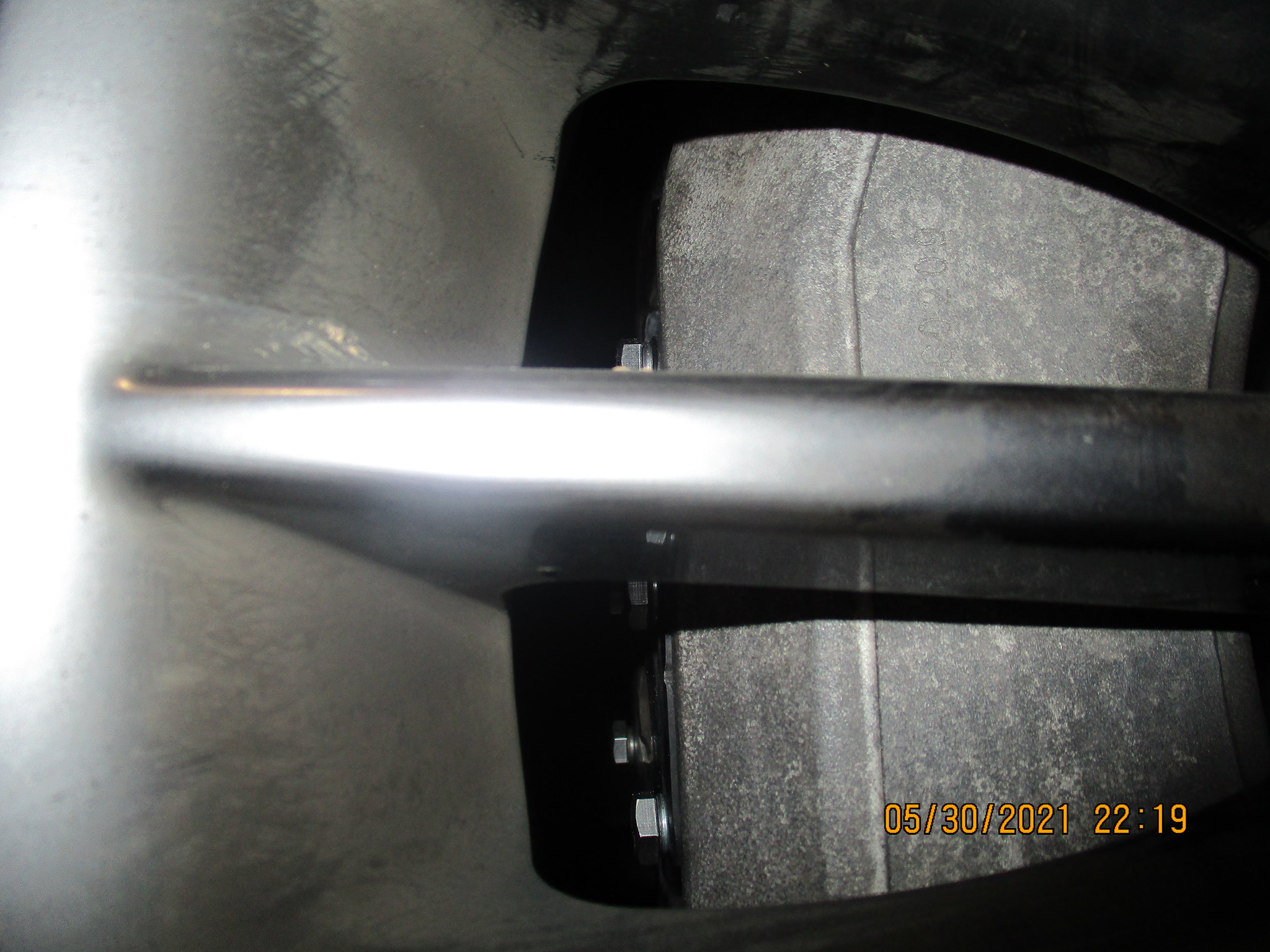

Today I had to drill out a couple of broken bolts that hold the front brake pad bracket in place on the caliper when I swapped my brake pads and rotors.
The stock 10mm M6 bolts only needed about 7 ft/lbs, but I used my older Sears right angle Nextec impact(strong little driver) to mistakenly tighten them to about 50 ft/lbs since the impact does not have an adjustable clutch. Seared the head off one bolt right away and one other was cracked and broke on removal.
The good news is that the plate has six bolts, so i was able to use the remaining four bolts to hold the plate in place until I could buy replacement 10mm M6 bolts and remove the broken bolts.
I end up using shiny stainless steel M6 bolts with matching washers to replace all six of the stock black M6 bolts. Fits perfectly, however the black painted stock bolts seem to be stronger rated bolts since they were tough to drill out or make a pilot hole into. However, I used a reverse drill bit and small bolt extractor pliers to remove the broken bolts with success. The reverse drill bit actually moved the bolts threads that was flushed in the caliper. When the reverse bit moved the broken threads enough to be gripped; I used the bolt extractor pliers to turn them out.
So my advice is to just hand tighten the front caliper pad bracket bolts to avoid breaking the heads off since they only need 7 ft/lbs to tighten since they are a pain to remove if broken flush in the caliper. However, if you lose or break the front pad bracket bolts; 10mm M6 bolts is the replacement size.
I probably could have just let the four remaining bolts hold the pad bracket in place, but I just feel better knowing the bracket is now held by all six bolts as designed. However, the bracket does seem like overkill to retain the pads if the slide rods fail compared to other four piston brake systems that only use wires and clips to hold the pads like Toyota.
New shiny brake pad bracket 10mm M6 bolts. I forgot to take a picture when the wheel was off.

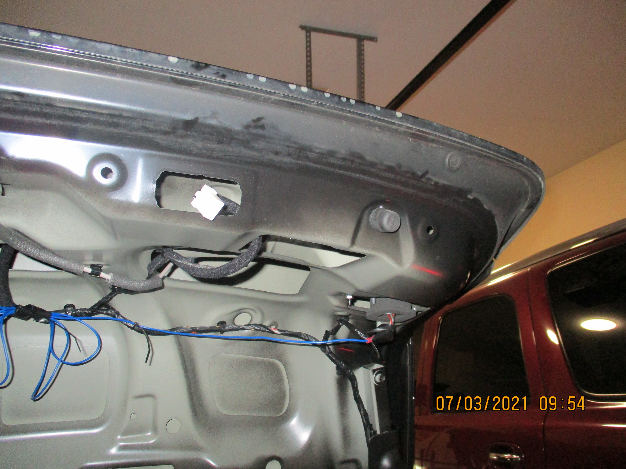

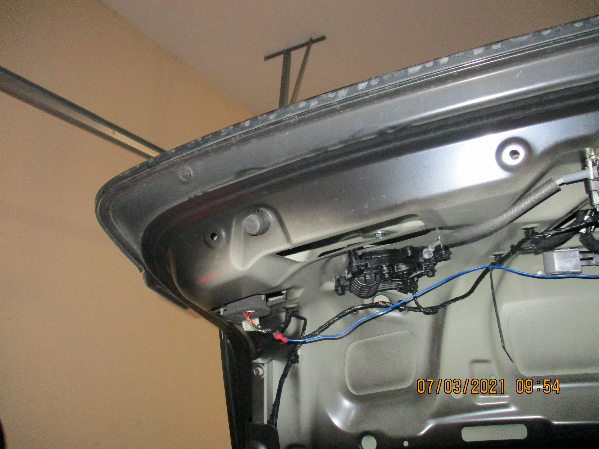

Today I performed a temporary right inner rear taillight wiring repair on my 2015 Genesis. I had to jump the #4 tail lamp connector wire to the left side inner taillight wire, and the tail light works. However, it looks like i will have to jump #5 and #6 as well to get the taillight fully working. At-least now the taillight is not out completely and still has the turn signal.
I guess that the three wires in question are broken somewhere on the trunk hinge harness. Seems to be a common problem on the Genesis. I may trace the broken wires and properly fix them at a later date.

I found the TSB related to the trunk wiring harness. This TSB helps big time and clarify what went wrong with my taillight.
Here is few clips of the whole procedure.
I also found the ABS fuse related recall TSB for the 2015-2016 Genesis on the service website. It seems like the 2015-2016 Genesis only need 20A and 25A fuses with no software updates or mandatory ABS inspection.

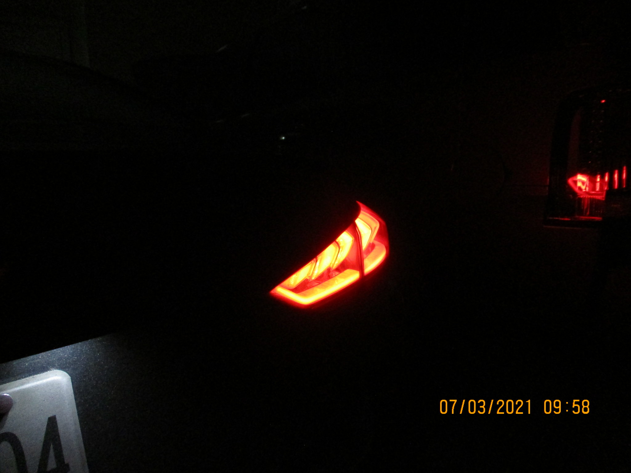

Today I fixed three broken inner taillight wires as per the TSB and now my inner taillight work perfectly; brake lights and all.
My advice would be for anyone with a 2015 or 2016 Genesis model is to check to see if the right side inner taillight harness has been relocated to prevent the wires from being too stressed and breaking. Either check yourself by pulling the trunk trim or have a dealership check it before the wires break. The car does not give a bulb out warning for the inner taillight if it is out. This repair job could be expensive out of warranty if a mechanic does the job, especially if the wires are broken.
My broken inner taillight wires.
Inner taillight wires repaired. I used aluminum foil to protect the good wires when I applied heat for the shrink wrap tubing. I relocated the wire harness as specified by the TSB and used cloth electrical tape to protect the harness from chaffing when the trunk lid moves.
