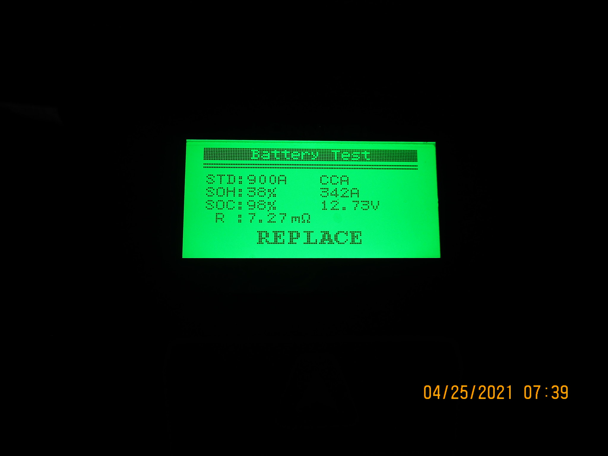

Today I tested my car battery with my new battery tester that also load test the battery. Device work perfectly, however it gave me some bad news about my 6 year stock battery. It holds the proper voltage just fine, but it only can make about 330 CCA which is less than half the 900CCA rating when new.
So I will just buy an Diehard H9 AGM battery from Advance Auto since they now own the former SEARS battery brand.
Note: The engine still starts like nothing is wrong so I would never have known my battery was on its last legs if I did not test it. Probably will die in the summer at the worst time if I do not replace it.

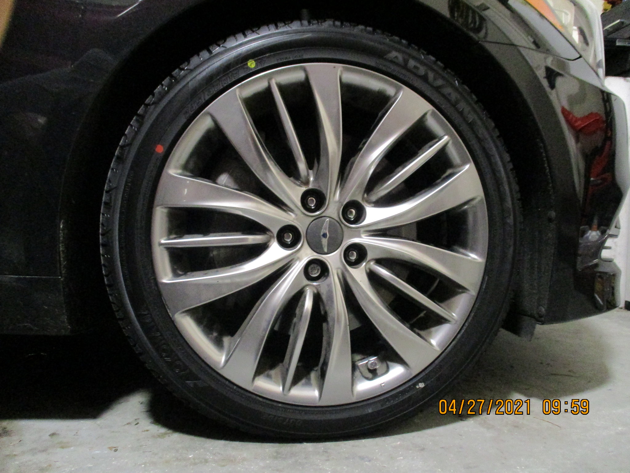

Big day today. I replaced my original battery for a Diehard H9 AGM 950A battery from Advance Auto Parts and got some new Yokohama ADVAN A/S+ tires from Discount Tires.
The ADVAN A/S+ tires actually seem to handle pretty good so far, so they may not give noticeably lesser performance than my old Falken FK510 summer tires. However, my old Falken FK510 tires was worn down so I probably got used the reduced performance which makes any new set of tires seem good.
The new tires.

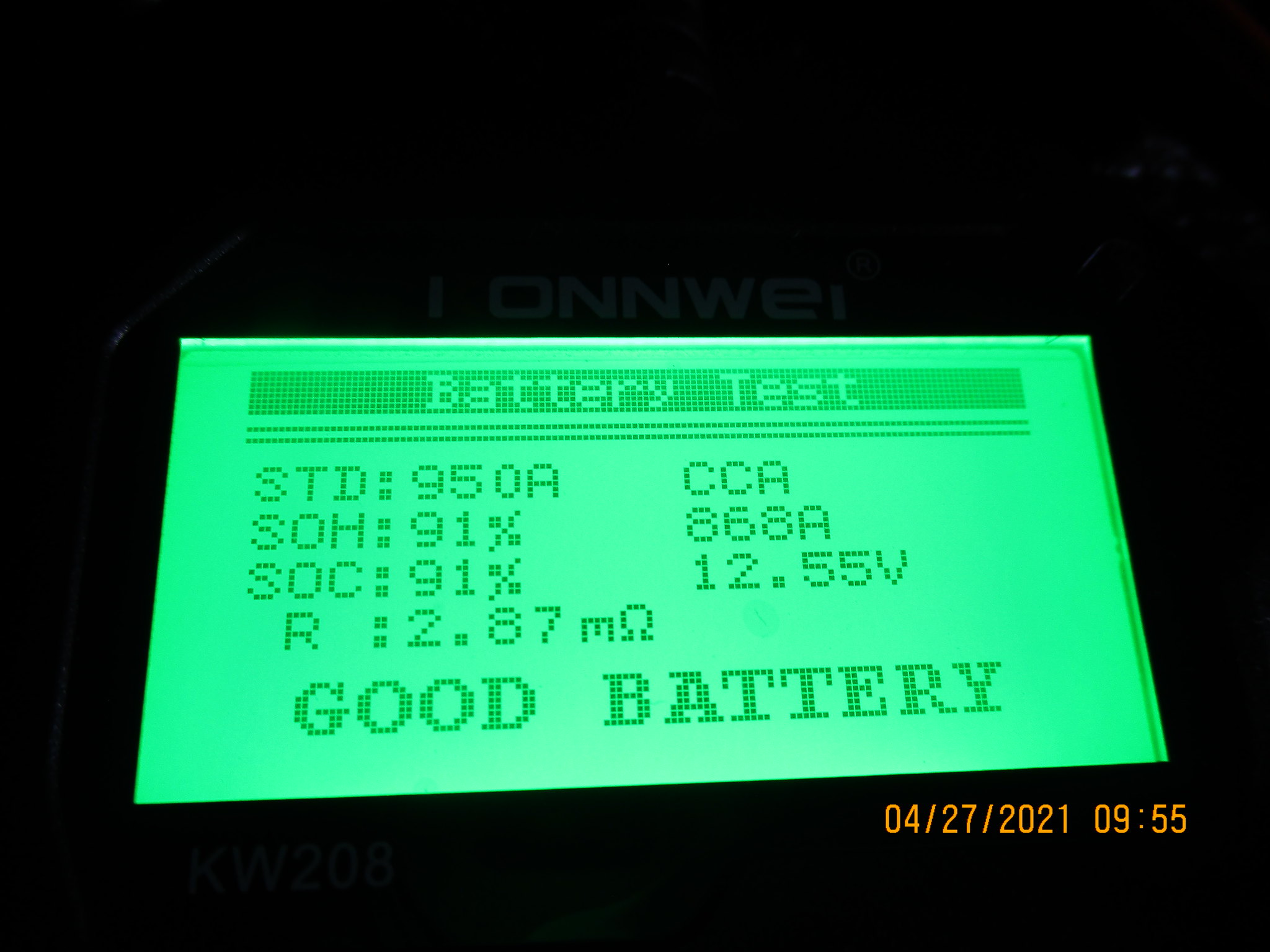

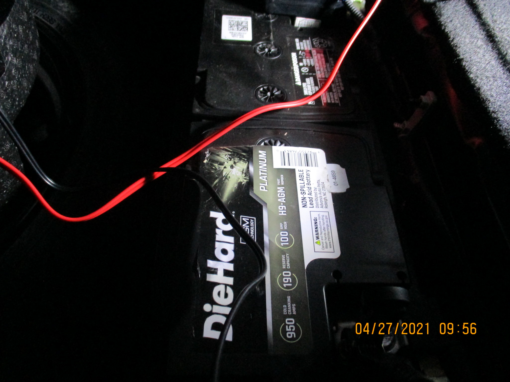

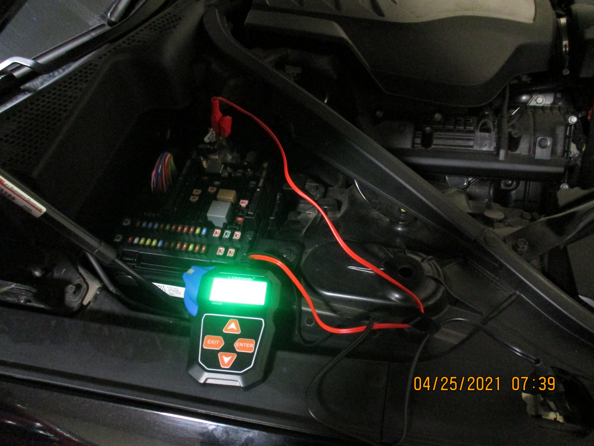

My old battery may have been still good since the the tester do not read the load well from the front battery post under the hood. The new battery also failed the load test when checking the battery from the front battery posts with the same 330 or so amps as my old battery.
However, the new battery checks out fine when I connect the tester directly to the battery in the trunk. Oh well, I probably still needed a new battery anyway due to the age. Too late now; even though I could have used the extra money to upgrade to some Michelin tires today. So do not load test your battery from the front battery posts under the hood since the reading will be incorrect.
My new Diehard H9 AGM battery.
