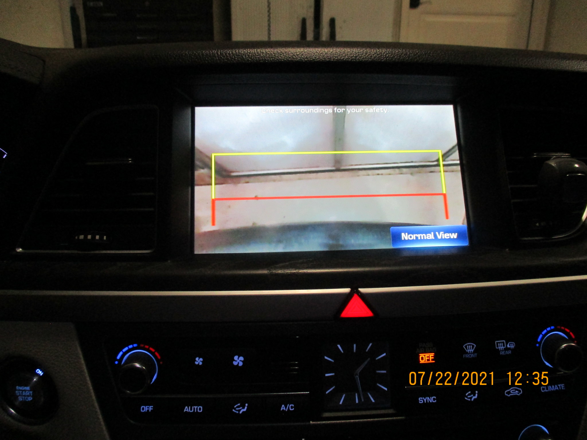

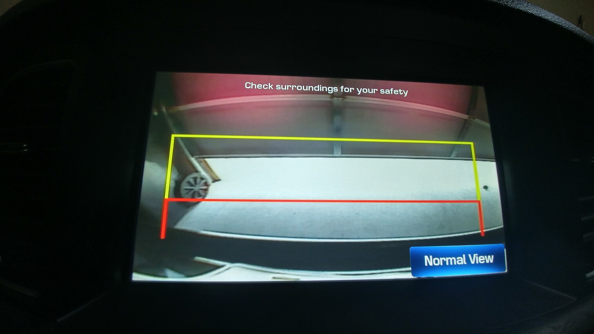

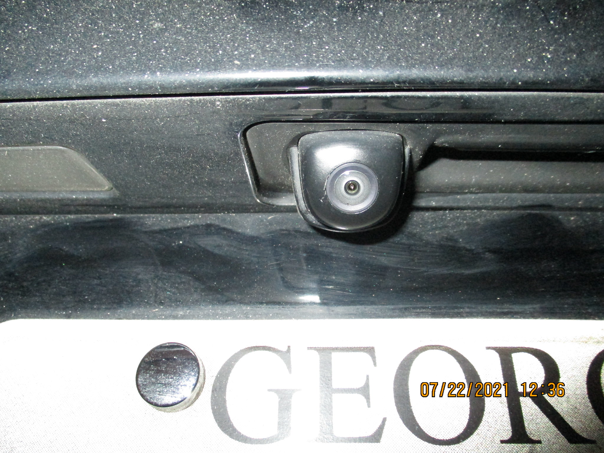

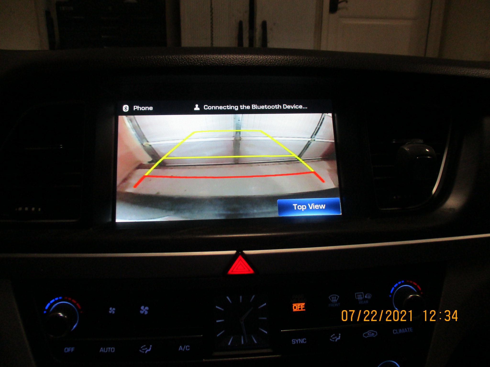

Today I cleaned my dirty hazy backup camera lens with some Invisible brand glass cleaner and Q-tips. The cleaner worked and got the camera image sharp again which is great. However, the best thing is that my camera works perfectly now when I switch between normal and top-down modes. My reverse camera never worked correctly ever since I bought the car in 2018. The reverse image was stuck in normal mode; only the guide lines changed.
Now it works. I do not know if repairing the wiring harness solved the issue if the camera mode system is electrical or if the cleaner somehow loosen up a stuck camera mechanism if it changes the angle of the lens mechanically. All I know is that my reverse camera system works like it should after three years.:)
I know that a backup camera is not an exciting topic to many of the members reading this, but it is to me since my car is actually working like it should; even in small part such as with the backup camera.
Now I just have to clean the rest of the car.
Working camera finally.
It used to do this in top-down mode; same view as normal mode except the guide lines.
I suspect the wire harness repair fixed the camera angles. Good call on cleaning the lens. I will do that today.
You maybe correct. I did have to wrap the gray camera cable in the harness with electrical tape because the wire jacket was split with wires exposed. None of the wires seems broken, but the exposed wires could have been touching something that caused the camera to act weird.
However, after much thought; it could have been a simple module reset when I disconnected the battery to work on the harness. The battery was disconnected for a couple days, so the camera module probably corrected itself on reboot when I reconnected the battery. I never checked the camera modes until yesterday when I cleaned the camera lens.
Well, anyway it works like it should now regardless of the reason. However, it would be good to know what solved the issue if the camera modes get stuck again.

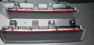

Replaced the upper brake light so it does not flood the rear cabin with the red brake light due to corroded rubber seal.
How hard was it to change your upper brake light? My rubber is starting to crack and I want to change it before it gets too bad.
He wrote up something in another thread - pull down rear headliner 3-4 clips pop out. Then use a small socket to remove 4 bolts. Remove wire. Slide out - replace.
Or buy black Gorilla tape and cut a piece to fit - save $140 :)
The gorilla tape is Tacky, literally and figuratively. Just wrong for a nice car. The job was easier than I expected. There is a great DIY write up here somewhere. Best tip is to remove the 3 rear headrests so you can lay on top and access the area. Also the headliner will bend and crease slightly when being forced down, but the slight crease will massage away. Go for it.
