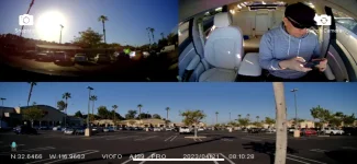

I removed the plastic trip in the trunk and ran the rear camera cable through the rubber grommet in the trunk door for a more factory look. That part was probably the most difficult as there isn't much space to push the cable in. Everything else is hidden in the headliner without getting in the way of the airbags. I used the AC fuse for constant power on for parking mode and a module fuse for the ACC power. The ground point I used is one of the nuts down near the dead pedal.
