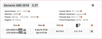

The Kia Stinger Limited GT has the same staggered tire setup as the G70 3.3T Sport. The Kia Stinger and Genesis G80 has a bolt pattern of 5 x 114.3 (67.1mm Center Bore) It could very well be possible that both Kia and Genesis use 5 x 114.3 as a company standard. From here, it wouldn't be too far to maybe assume that the G70 would also use these wheel specs.
The Kia Stinger fronts are 225/40ZR 19 on 19 x 8 ET34. The rears are 255/35ZR 19 x 8.5 ET 46.5.
(Please be aware that my information may NOT be correct).
I think getting the same staggered wheel setup with the same offsets from the after-market will not be easy. To get the same center bore will even be more difficult. At least you can use rings.

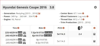

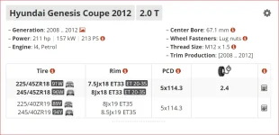

Well it looks like the g80, g90 and the previous hyundai genesis coupe have the same center boar and thread size. It may very well follow suit that the g70 does as well. Offsets vary a little but look ok. More rims to choose from for winter tires perhaps?
