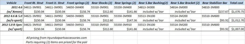

Hard for me to improve on ScottDK's post, but being a geek, I put a small spreadsheet together and thumbnailed a jpg of it with all the part numbers and costs I was able to find.
Hoping to do this on my 2011 4.6 at some point. Hope this might help some other drivers.
Thanks for you time on the spreadsheet Jeff:cool: I just took an Excel class a few weeks ago, so now I'm finally up to par on spreadsheets.
