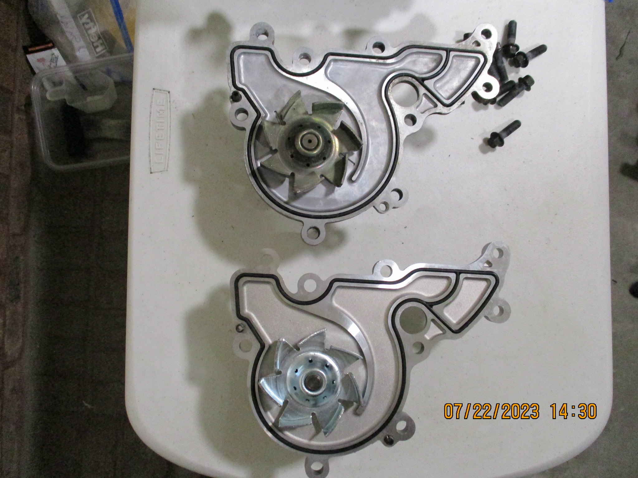

Well, I just found that AISIN(Toyota part supplier) makes replace water pump replacements for the 5.0 engines. Therefore, I decided to add one more part to change to the list; the water pump. The OEM water pump is over $300 dollars, however I was able to pick up an AISIN brand water pump for about $60 on Amazon.
This is more like what I was expecting when I bought the Genesis; affordable part replacements on a nice luxury car. Now I am happy owning this car since I do not have to spend Mercedes like part prices on Hyundai OEM parts.:)

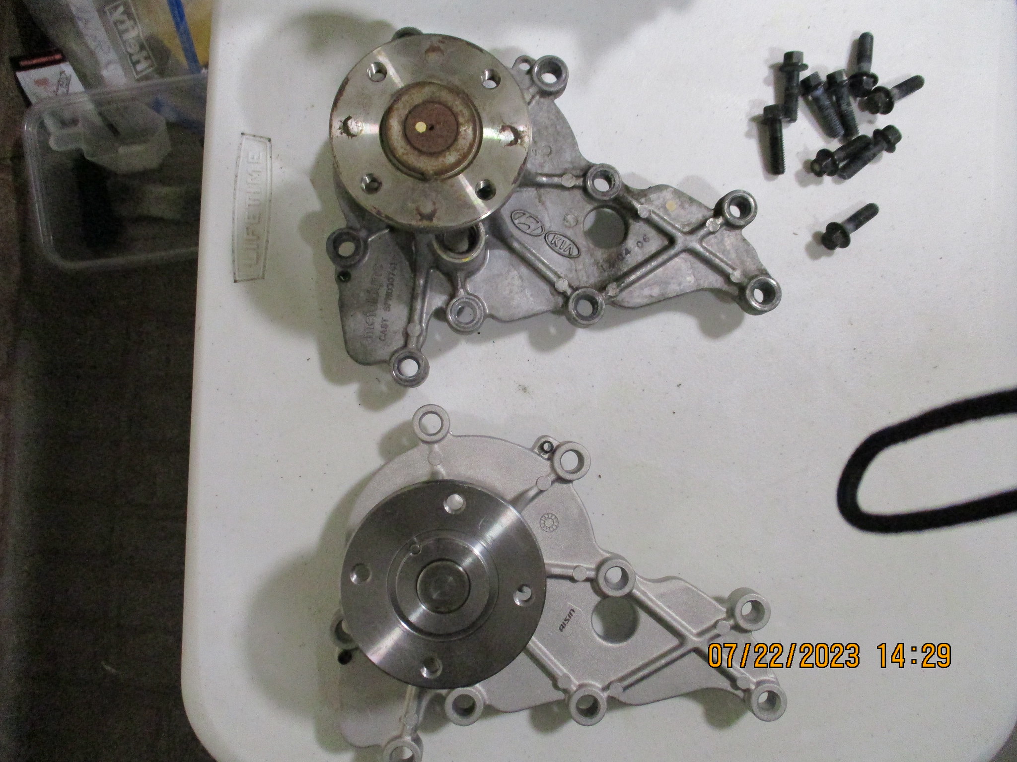

OEM water pump; hence why I did not swap it out at the time.

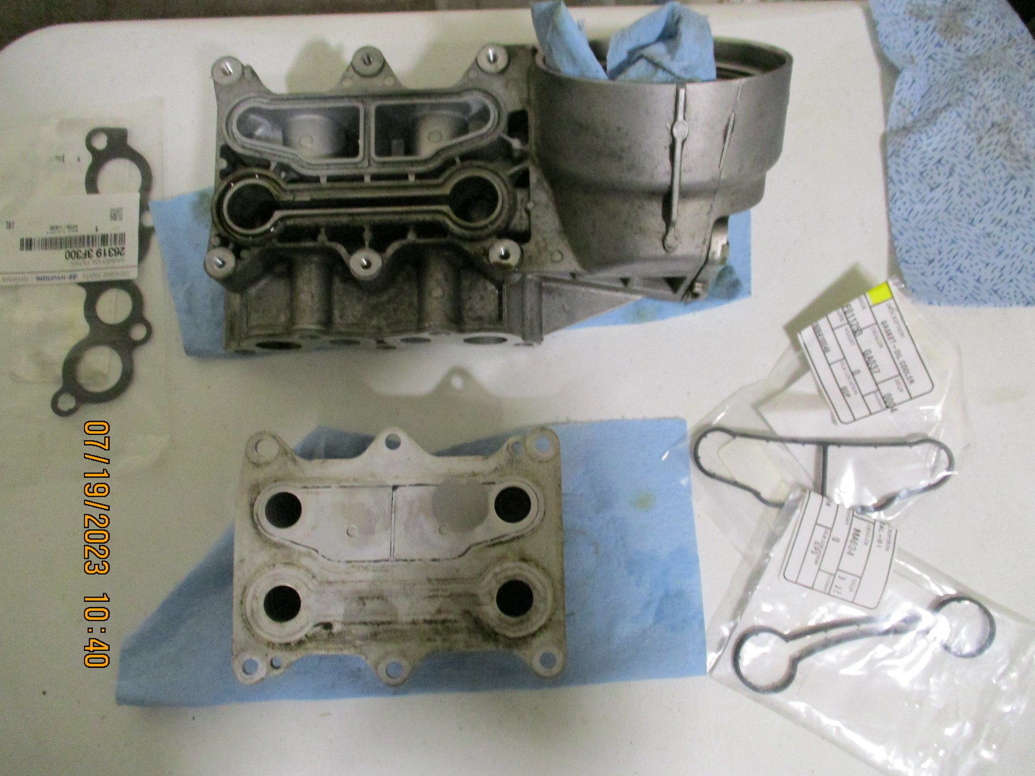

I finally got my oil cooler gasket set. I had to remove the oil cooler off the oil filter bracket to let the coolant and oil drain out from when I pull the cooler/oil filter assembly without draining the coolant from the engine block first.; which allowed the coolant and oil to mix in the cooler. I was able to drain the oil cooler of any(well most) fluid, but it required changing out the oil cooler coolant and oil gasket seals.
The oil cooler and gaskets. The upper inlet and out holes are for the coolant and the lower inlet out holes are for the engine oil. The oil filter/oil cooler assembly at the top with its gasket that separates both the coolant and oil ports for the cooler.
The AISIN brand water pump and part number.

Heck, the OEM Metal Dyne brand water pump that Hyundai uses on the 5.0 is maybe built better than the Aisin brand water pump. However, I am not spending over $300 on the OEM one to find out.
The Aisin water pump fits perfectly. The only difference was that it had slightly thicker alignment dowel pins than the old water pump that required a small rubber mallet to set in the holes.
My old water pump did have some back and forth movement in the pulley bearing, but it still rotate smooth overall. However, the new water pump bearing spins smooth and has no looseness in the bearing at all. My old pump would probably start making noise(and leak) at about 150k miles or so based on the bearing looseness at 90k miles, which is about normal for any engine.

The old OEM(top) and and new Aisin(bottom) water pumps. Both are the same design and fitment. However, the Aisin cost $60 and the OEM cost $330.

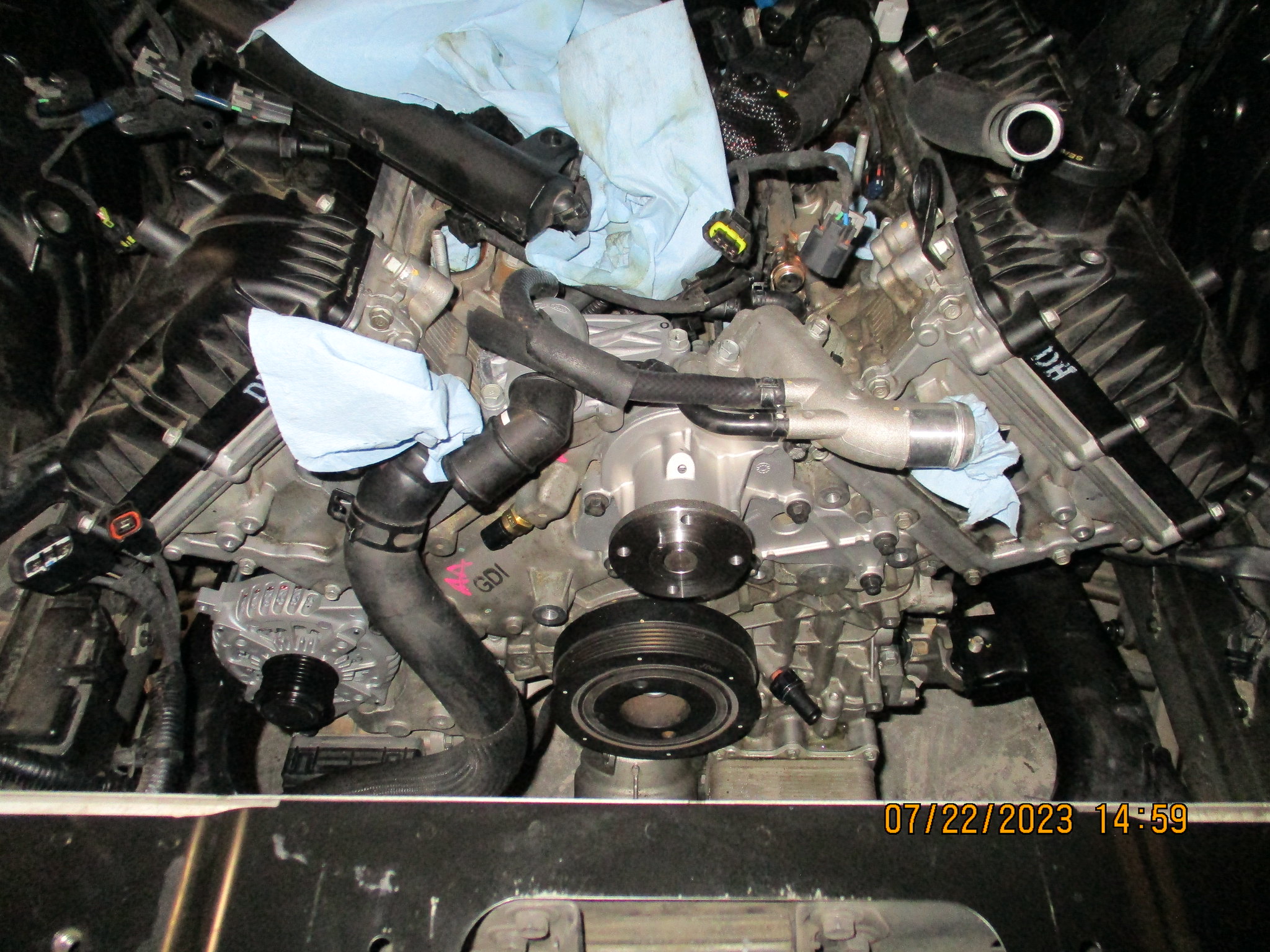

The new Aisin water pump installed

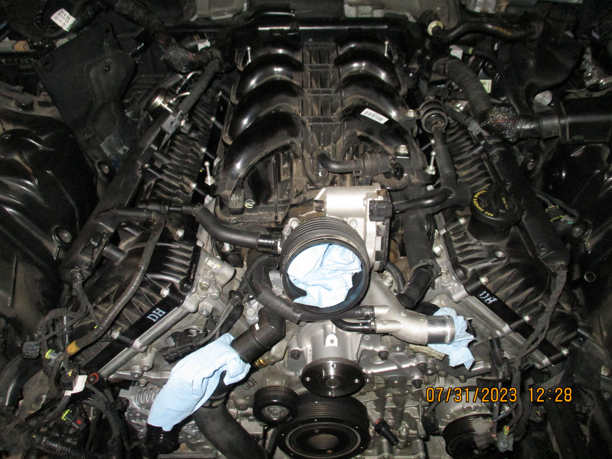

Man, the wire harness and hoses are a pain to sort out. But, it is sorted. Now I got to figure out where the darn wire harness and manifold bolts go. It seems that most of the gray 10mm bolts are for the wiring harness brackets and the black 10mm bolts are for parts attached to the top of the intake manifold or valve covers.
The intake manifold installed. Next, just sorting out the various bolts, brackets and hoses.
