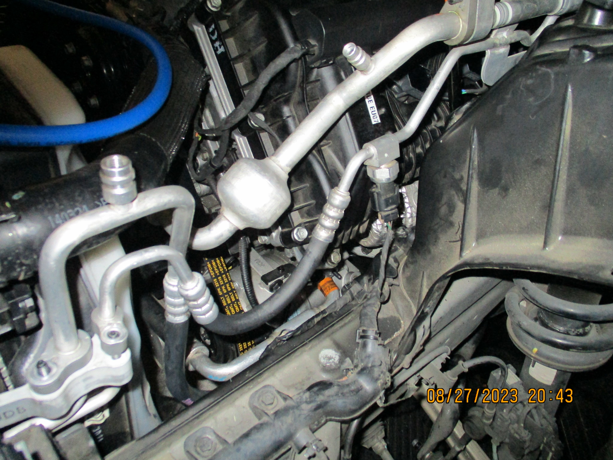

The AC system reinstalled; except for the desiccant pack.

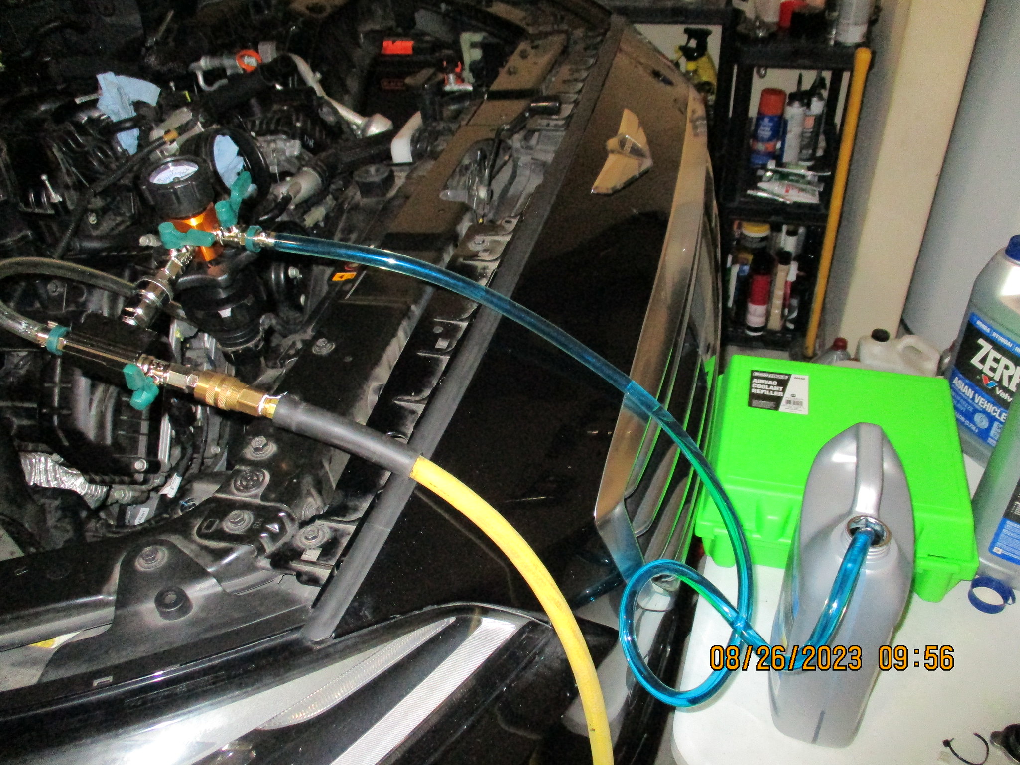

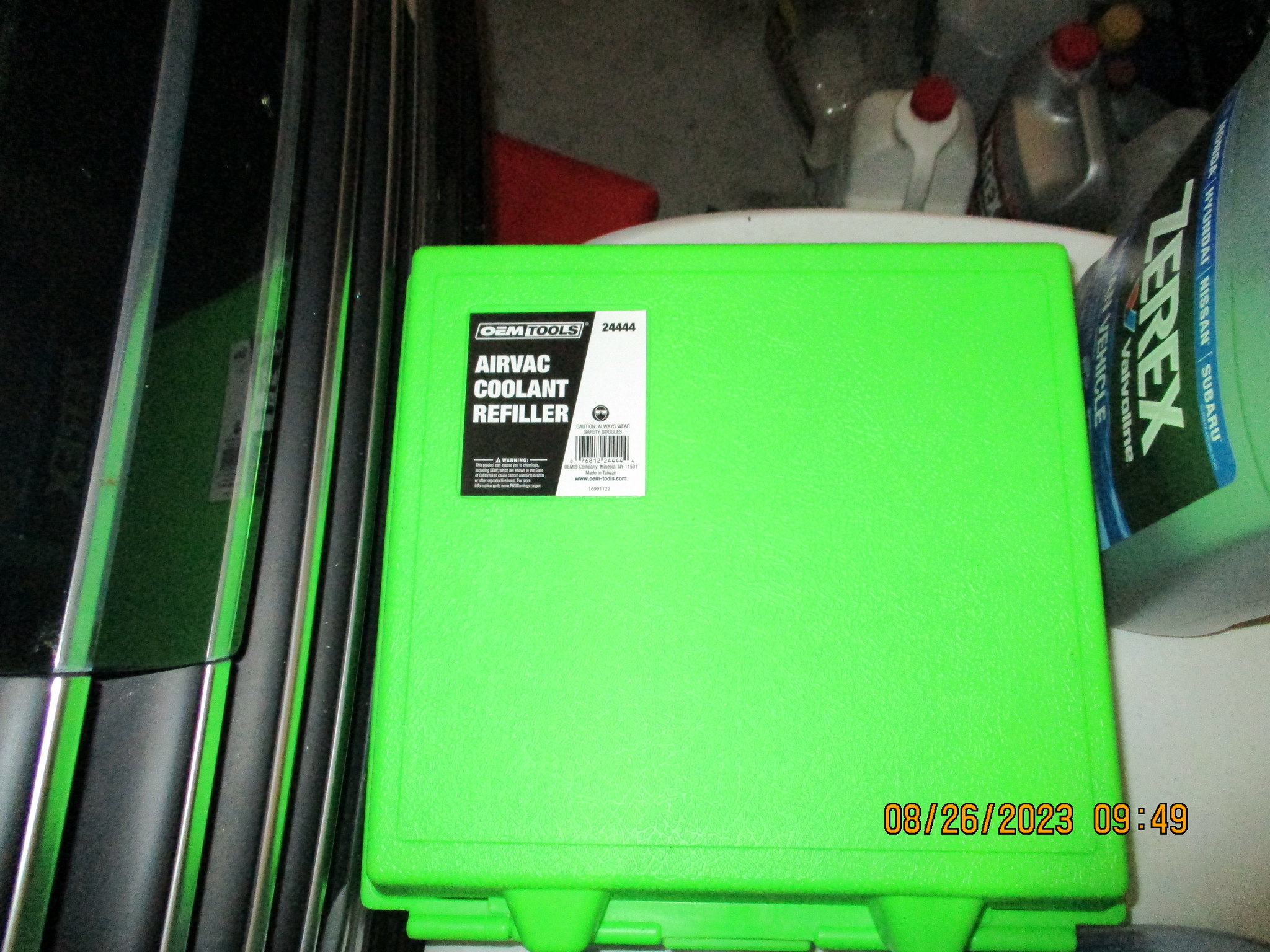

I ended up doing the coolant refill first due to having to start the engine to top off the AC system(run the compressor). I used an OEM brand coolant vacuum fill tool that uses a shop air compressor to pull a vacuum and then fill the coolant system. The $50 tool works well. I only had to manually top off the radiator.
I used about 2 gallons of coolant, but it may take another gallon to fully top off the system when the engine is running at operating temperature and the heater turned on. The tool filled up the system is less that a couple minutes. I will start the engine for the first time in a year when I add engine oil and then top of the AC system. This project is nearly done.

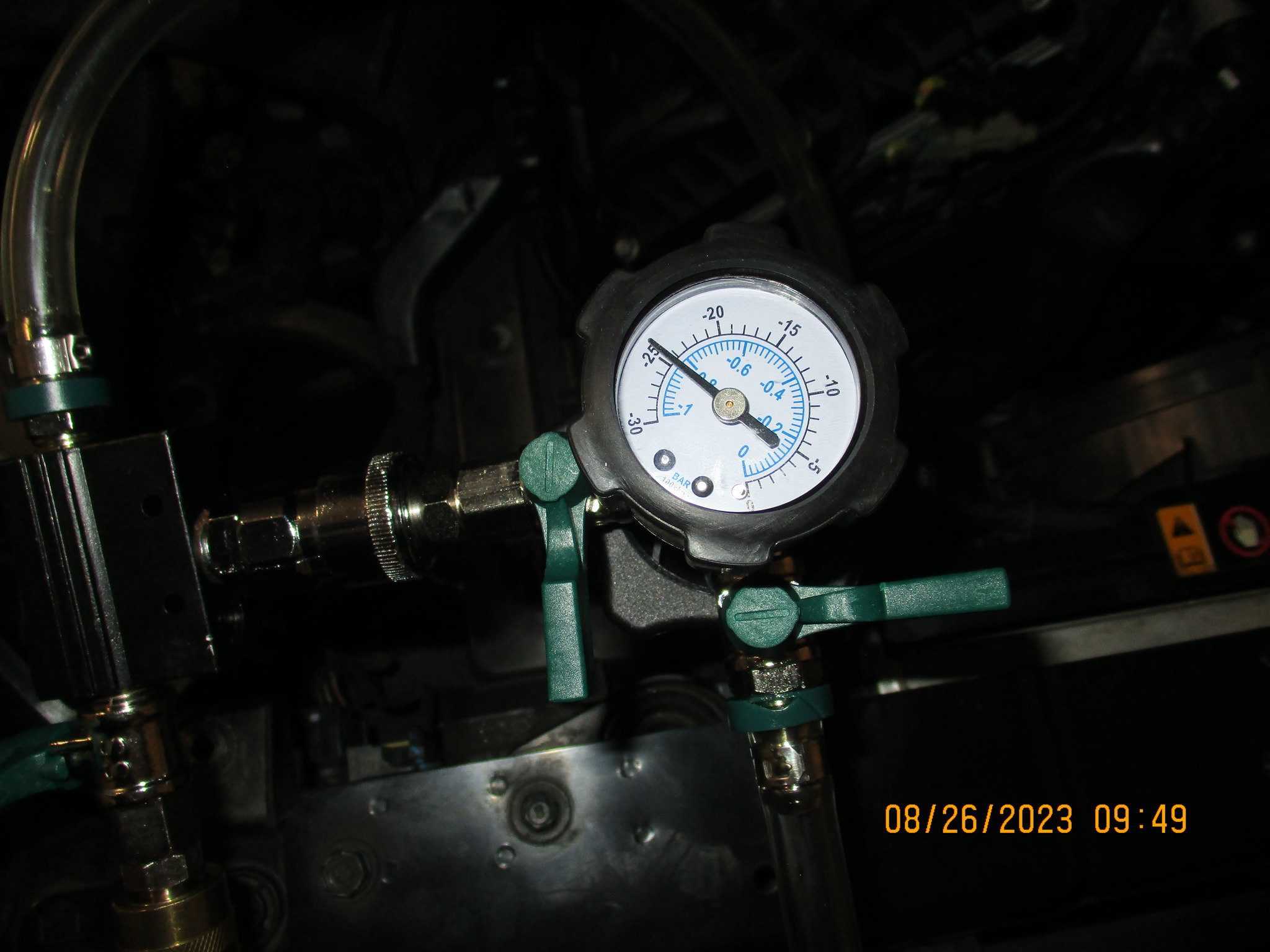

The tool I used. It fits on top of the radiator opening. I pulled a -24psi vacuum and let it sit for a few minutes to checks for any leaks before I added the coolant. If the gauges loses vacuum then it means a leak in the coolant system. My system held-24 psi the whole time. To fill the system you open the fill valve an let the vacuum suck in the coolant from the jug until the gauge reads 0, and then top off. The process usually fills the coolant system without creating air pockets.
