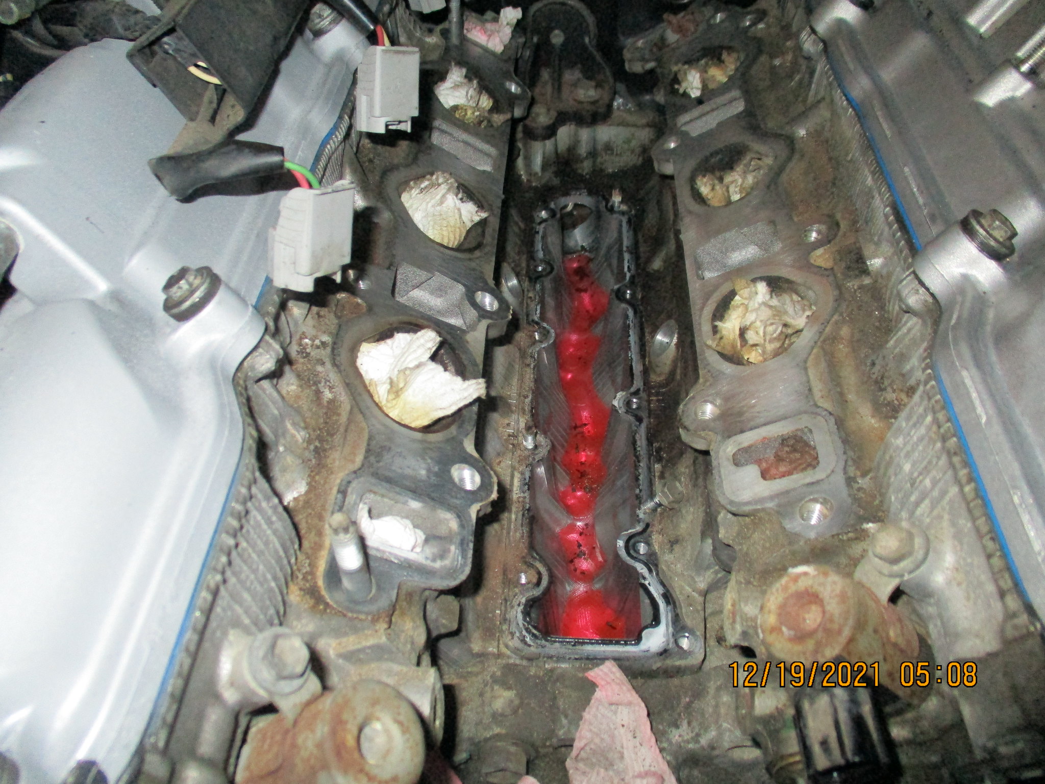

It is not that bad to be honest if you can work on an engine. The hardest part is getting the right tools for the job. It basically come down to removing nuts and bolts and applying RTV sealant.
I have broken down a few engines in my time to replace similar parts. I know enough to get the job done. The Genesis would the newest model car I have worked on. But it seems pretty straight forward.

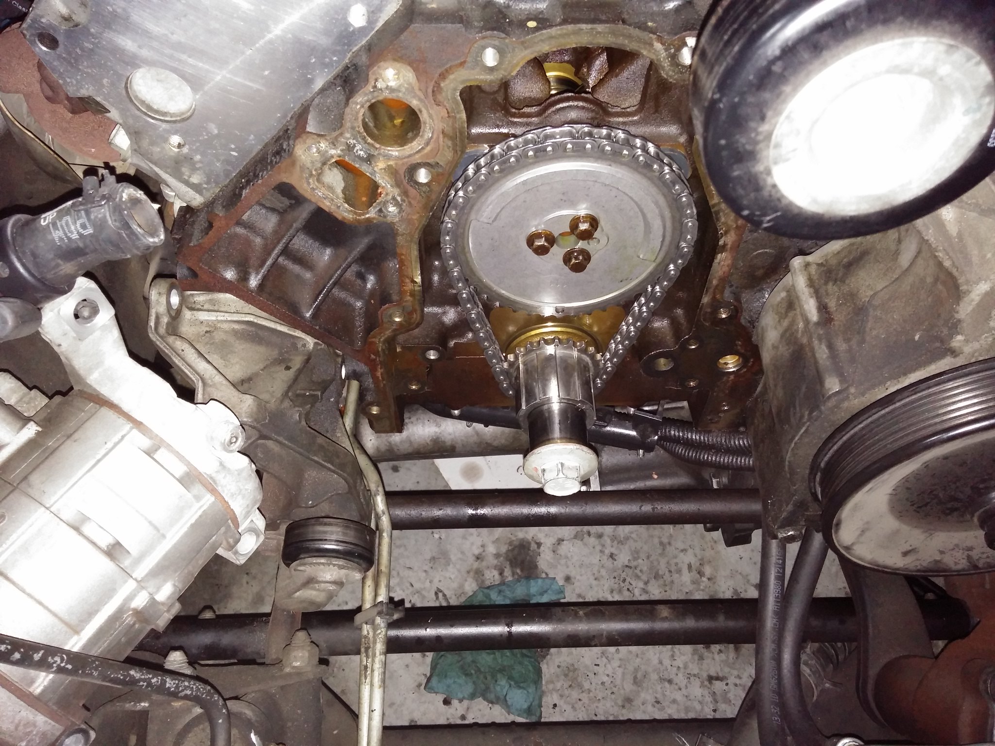

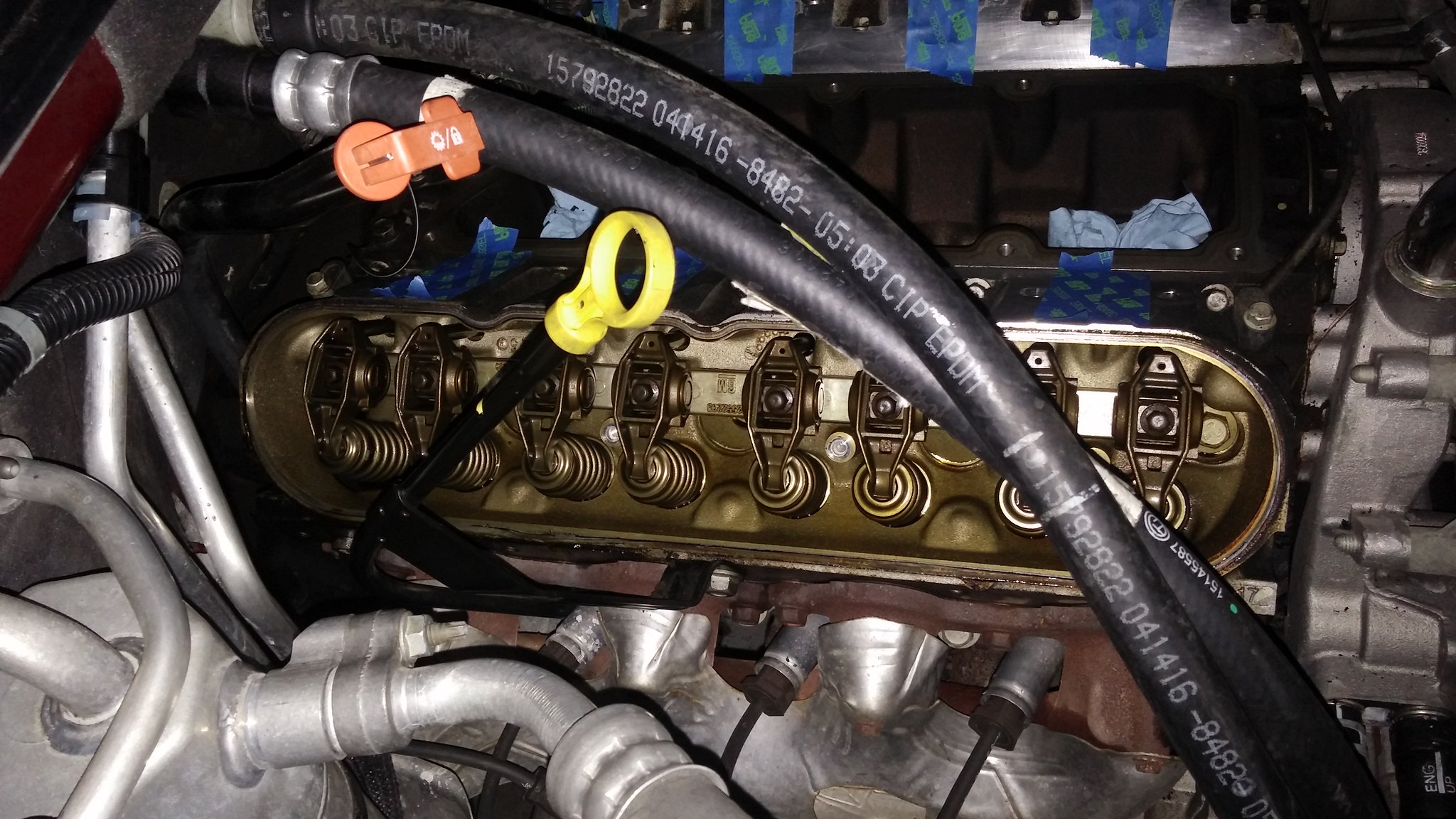

My latest projects before this one.

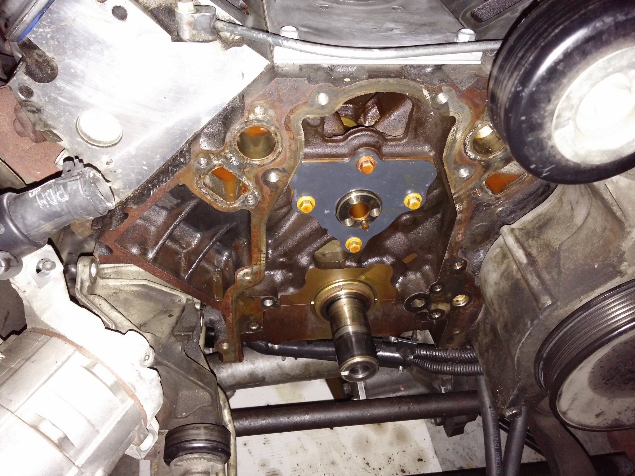

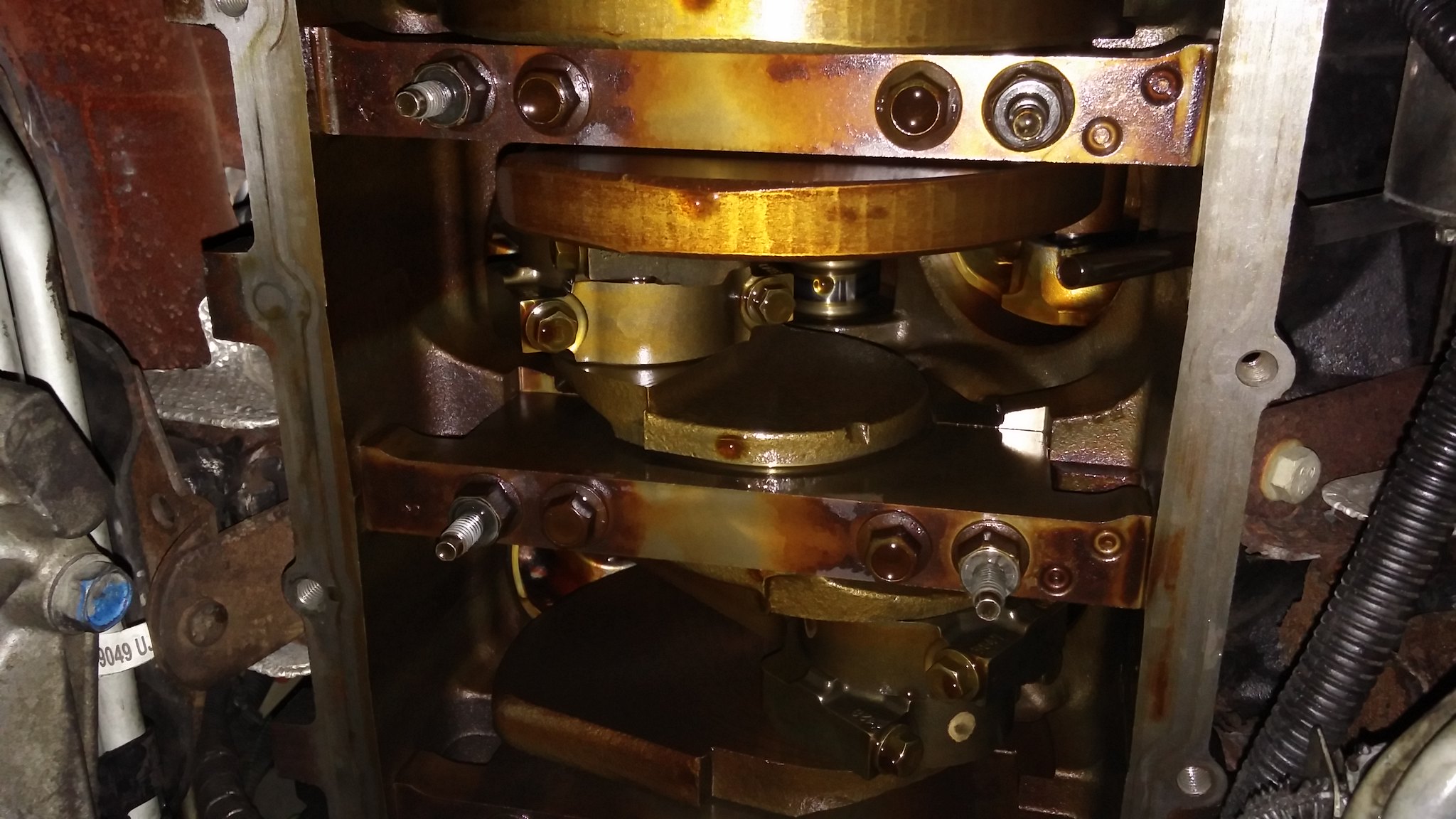

My 2006 Cadillac Escalade( my current back up ride) where I changed out the front timing cover,timing chain, valve covers, oil pump,oil pan etc. Basically a new refreshed engine at 226k miles. Runs like new.

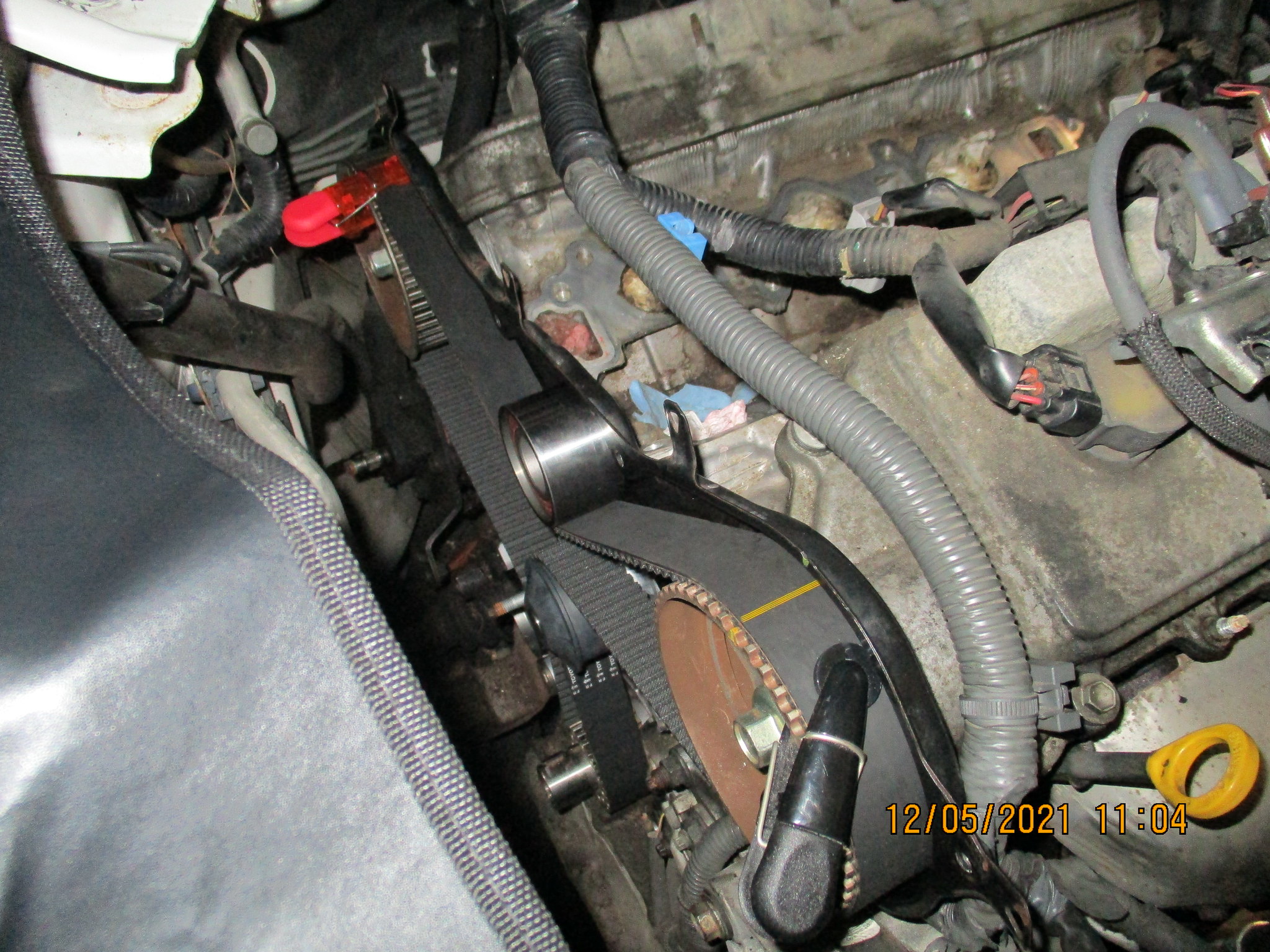

My son's 2007 Toyota Highlander timing belt, valve covers, water-let housing reseal, cam/crank seals, etc.

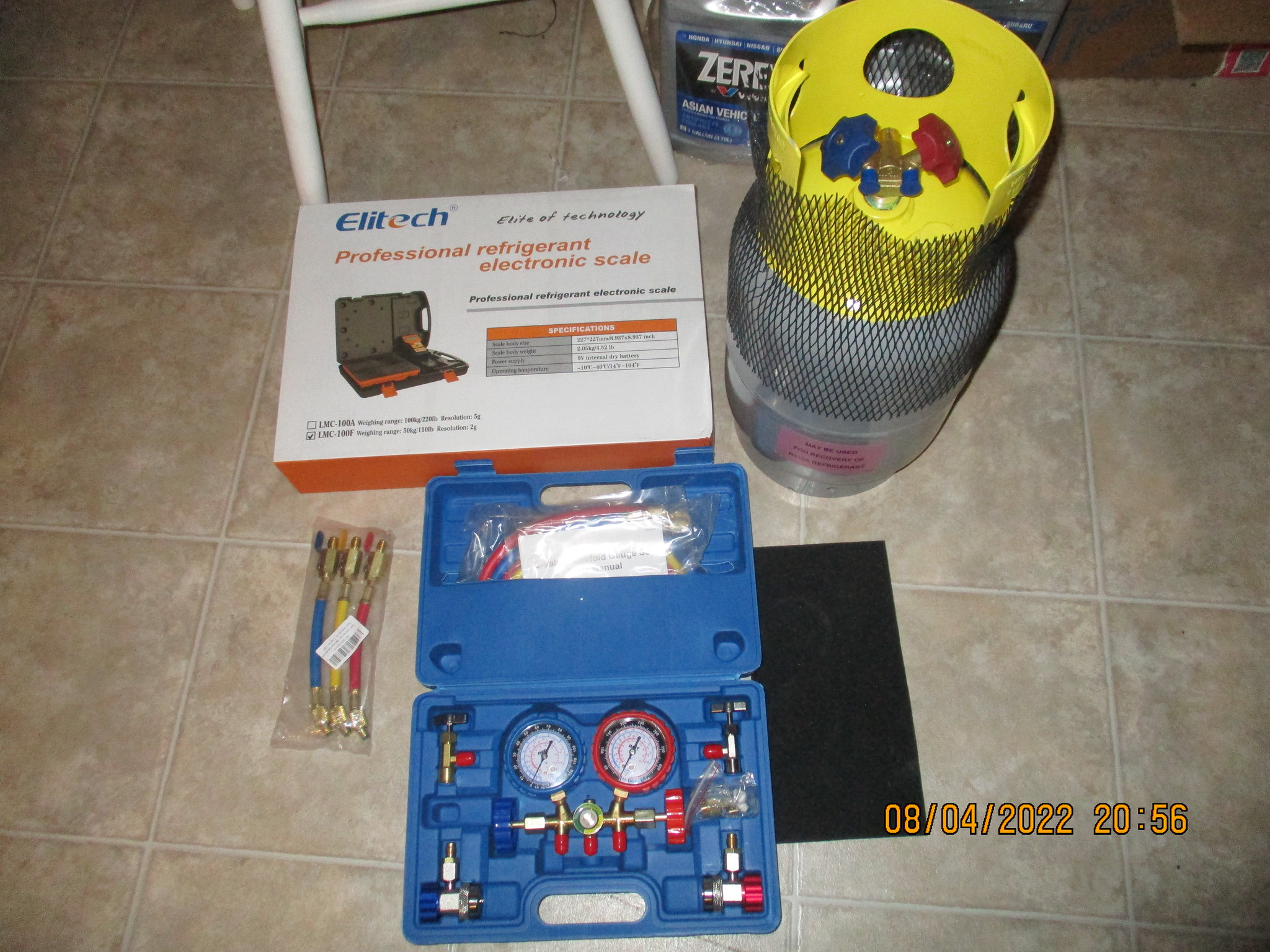

Today I finally got most the AC tools needed, but not the actual recovery machine. It is amazing that you can get darn near anything from Amazon.com.:)
I am waiting for the AC recovery machine so that I can pull the AC lines and compressor off the engine before I continue.
The AC tools(scale,recovery tank, and gauges). Cheap no name brands, but will get the job done.
Heck, I just bought a vacuum pump and micron meter since I was this far into it, because you must prep the recovery tank by vacuuming it down to less than 500 microns of negative pressure. So, I just said screw it and just bought the whole entire HVAC setup.
Now, my friends will hit me up everytime they have an refrigerant leak in their cars or need an ac repair.:)
