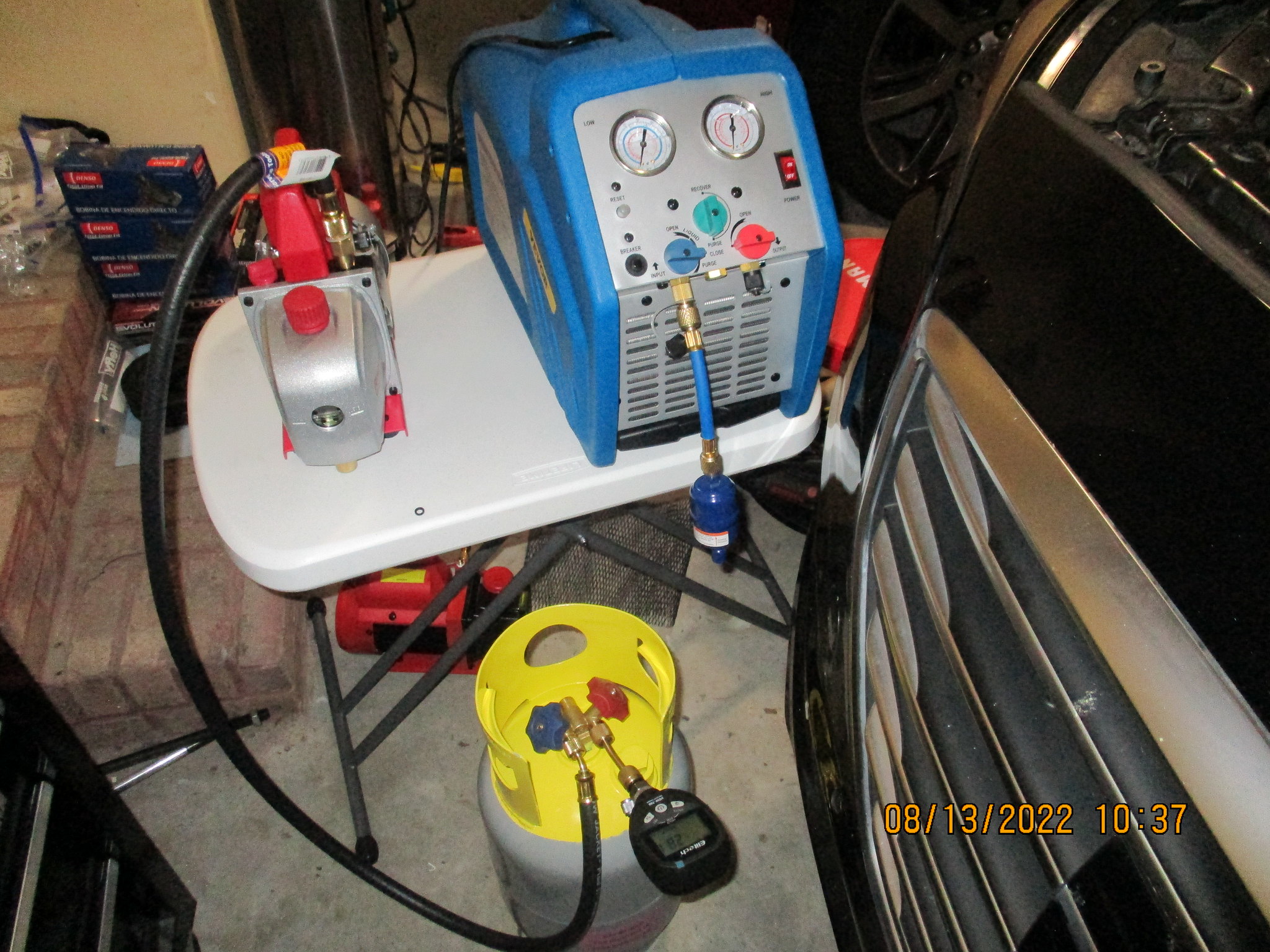

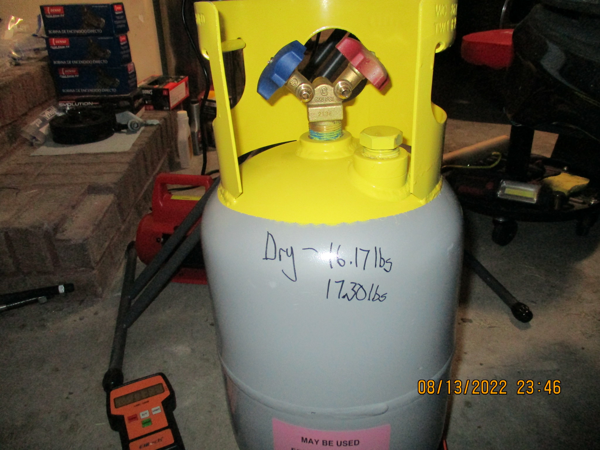

Today I finally got all my HVAC tools needed and got the recovery tank down below 500 microns of vacuum with a quality Robinair brand vacuum pump. The cheap OMT brand vacuum pump was useless because it could only get the tank down to about 3500 microns, so I have to return it.
Next I will pull out the 134a refrigerant and then the pull the AC compressor and AC lines.
It is good to have a vacuum gauge that reads microns and a good quality vacuum pump to pull a good vacuum to remove all water and air out of the AC system; including the recovery tank used to hold the refrigerant. Less than 500 microns is the goal. I pulled it down to about 280 microns.

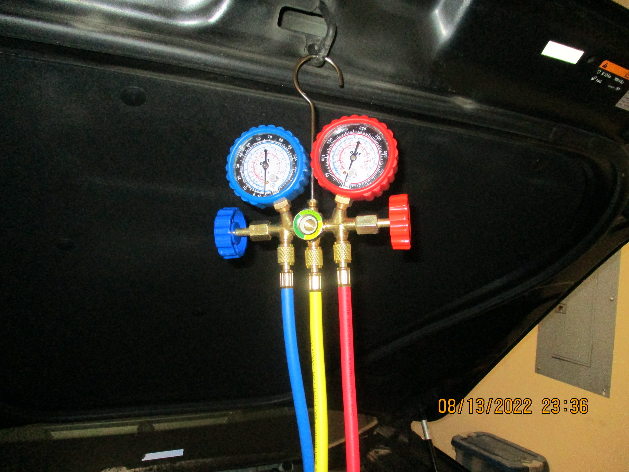

Alright; I pulled over 1lb of refrigerant out the Genesis. The gauges read zero psi or vacuum so I guess that was all(or most) in the system. Now I can pull the AC line and compressor.
My recovery tank dry weigh was 16.17 lbs. The weight after recovery is 17.30lbs. Now I properly remove my AC lines without causing harm to the ozone layer.:)
Now I have to pull my sleeves up and start the real work of this repair. The tear down.
The gauges and tank weight.

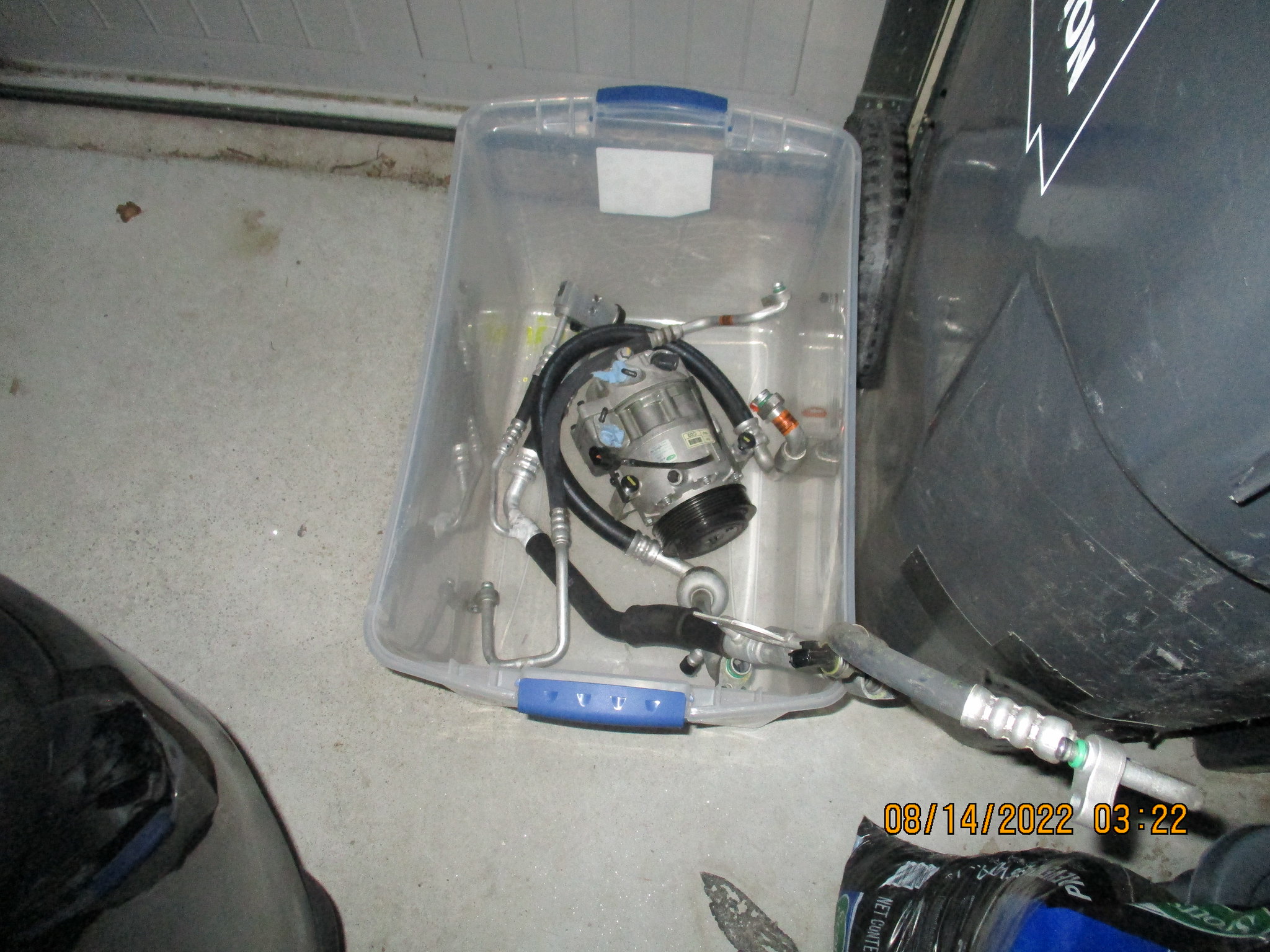

I removed the AC lines and compressor. The lines only need a 10mm socket(or wrench) and the compressor only needed a 12mm socket (or wrench) to remove. Now, I will do a little more planning and start removing the valve covers and intake manifold.
The AC parts removed. Now I have much more room to work with. I only need to remove the dip stick tube and the rest of the wiring harness to have perfect access to the driver side valve cover.

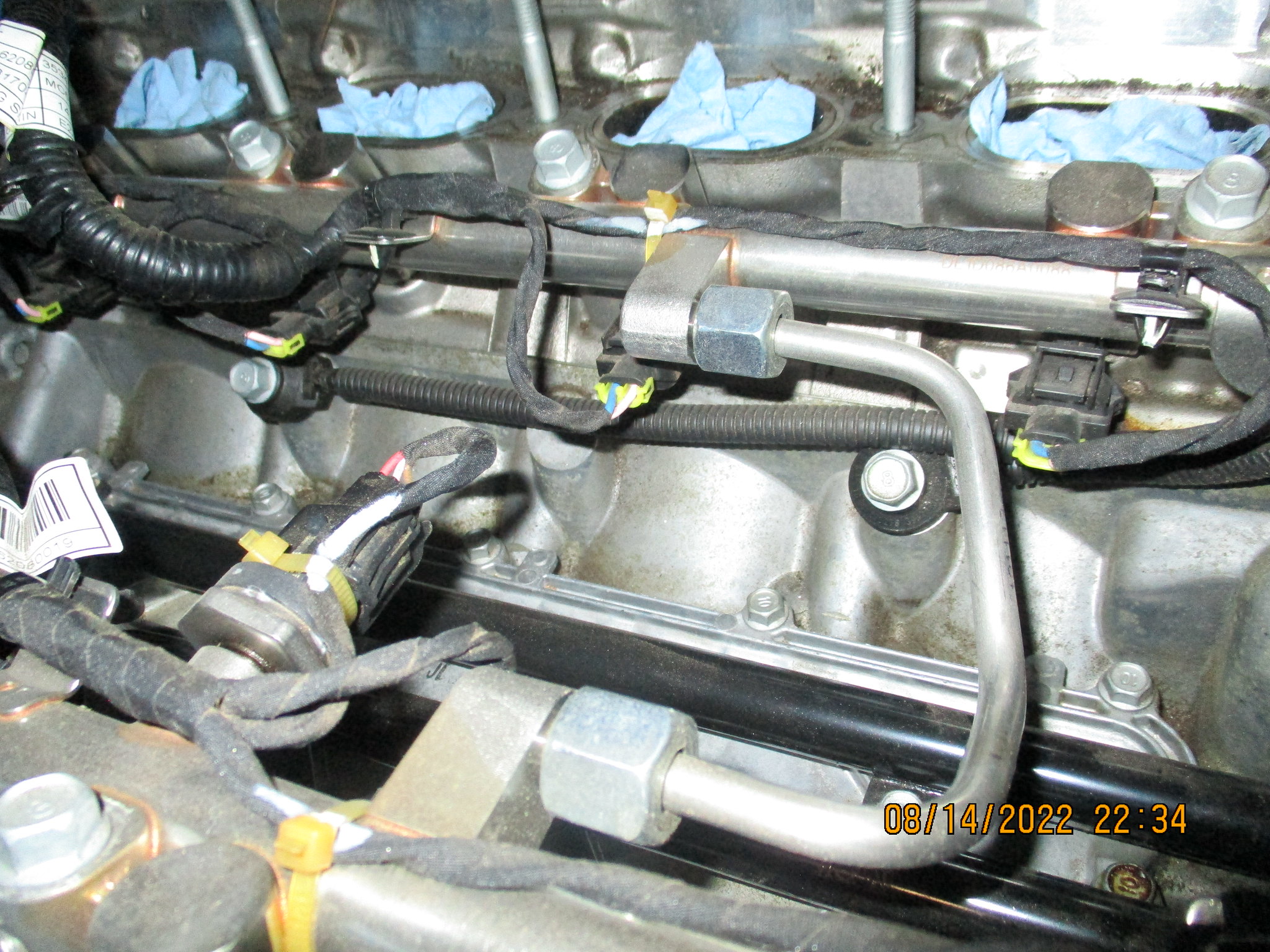

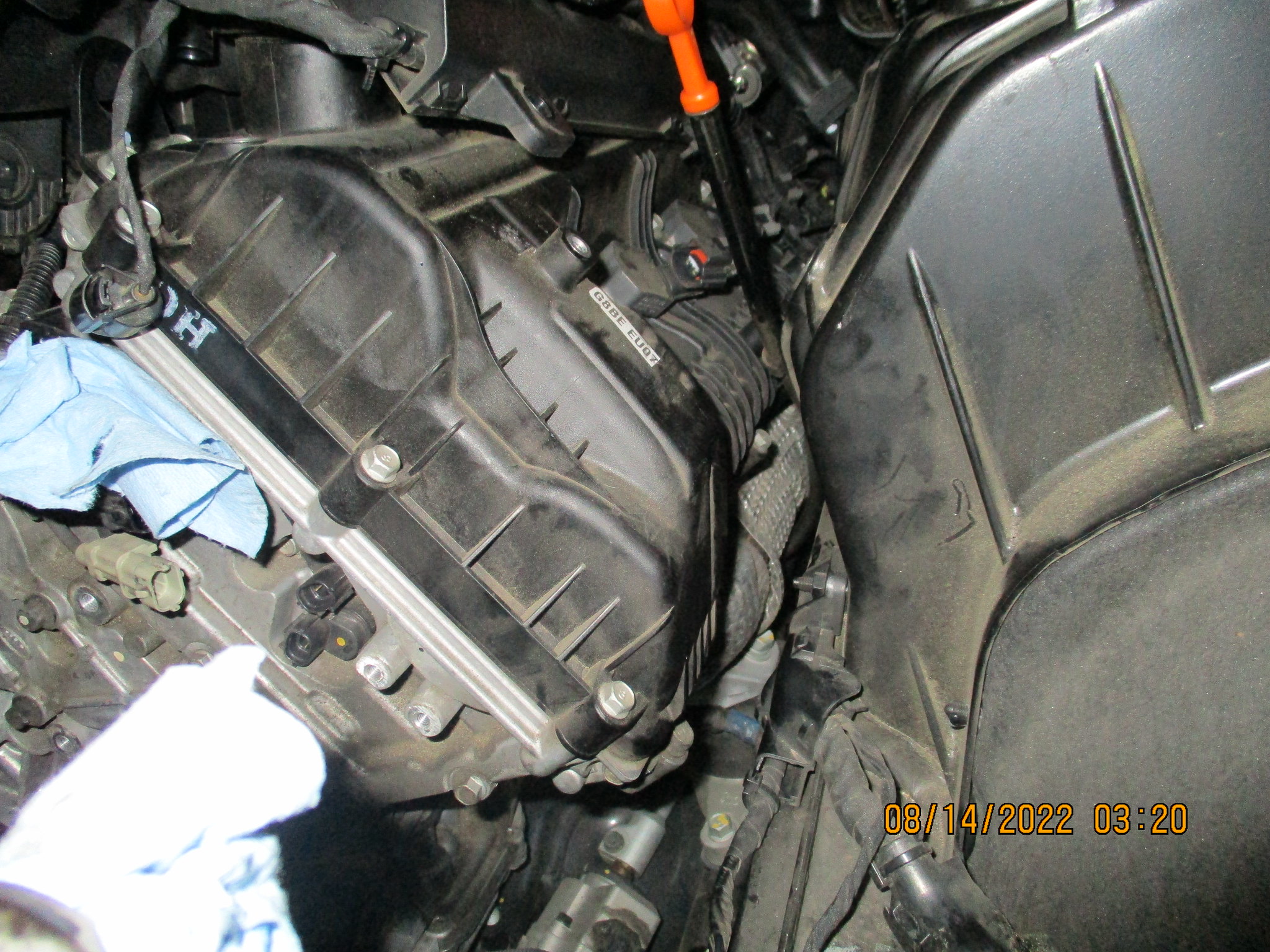

I decided to remove the intake manifold first. Not the easiest job, but not the worst intake I had to remove over the years. Hyundai did make it easy to access the valley area on the 5.0 engine. Toyota V6 and GM LS engines requires the fuel rails to be removed. Some other engines also requires a lower intake manifold to be removed as well.
The main hurdle on this engine is the various harness and hoses connected to the intake manifold that needs to be removed in a tight area.
I will change the knock sensors, coolant pipe o-rings, and clean the valve stems. My valve stems are dirty, but not as bad as some other direct injected engines I have seen with this mileage. The intake runners and valves are mostly clean for a directed injected engine with 90k miles.
The intake manifold removed. Perfect access to the valley area of the engine and valve stems.
Knock sensors
My dirty valve stems. Intake runners are also dirty, but not to point that they are blocked with carbon.

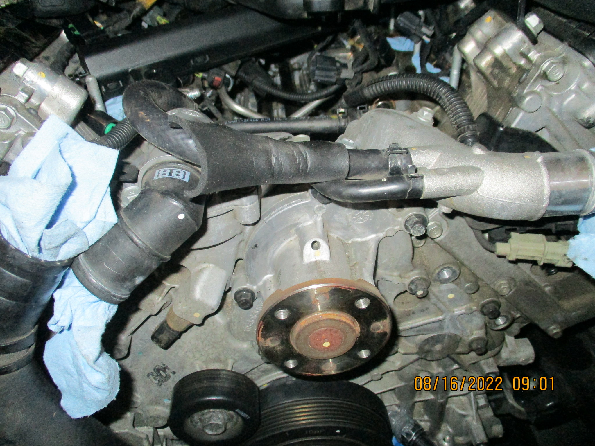

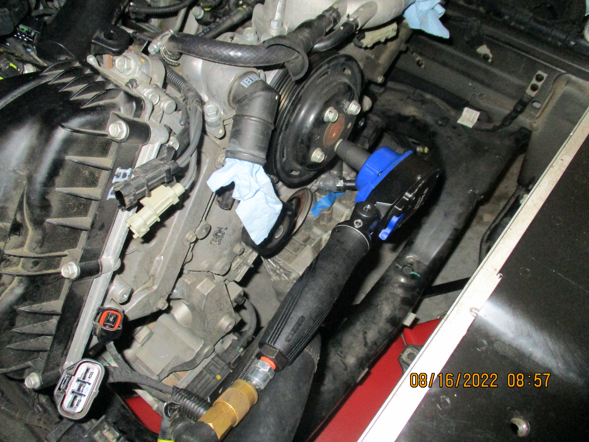

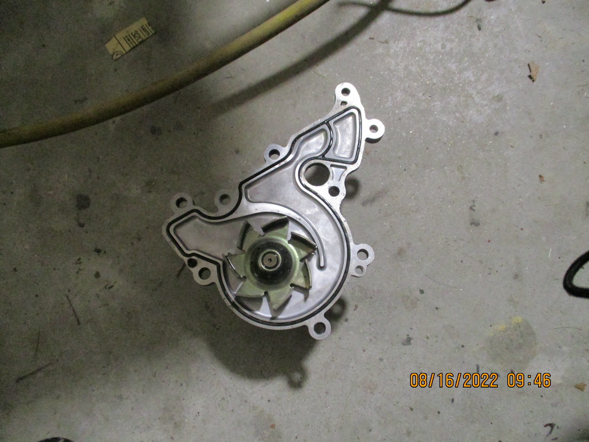

I pulled the water pump and it was also fairly easy to remove and was good shape at 90k miles. The hardest part was removing the pulley adapter bolts since it spins when trying to break the 12mm bolts loose. I ended up using an air impact to remove the pulley adapter bolts easily. The water pump itself is only held by nine 10mm bolts and two dowel pins. To release the pump form the dowel pins I used a small block of wood and a rubber mallet.
I decided to pull the water pump due to having two heater hoses that need to be removed that sits over the rear of the engine. The heater hoses still has some coolant trapped in them that is held by the water pump and would probably dump coolant in the open engine ports, so I pulled the water pump and drain the coolant left in the engine block and hopefully the heater hoses.
From what I tell so far; the 5.0 engine is made well and the typical wear parts are doing fine at 90k miles. Hyundai did a good job with this engine and it is fairly easy to disassemble.
Note: If you removed the crank puller(damper); put it back into the engine before removing the water pump to prevent coolant from going into your oil pan.
The best way to quickly remove the water pump pulley adapter bolts.
The water pump without its pulley adapter and it removed from the engine. It looks and spins as good as new. Even the gasket still seems good.

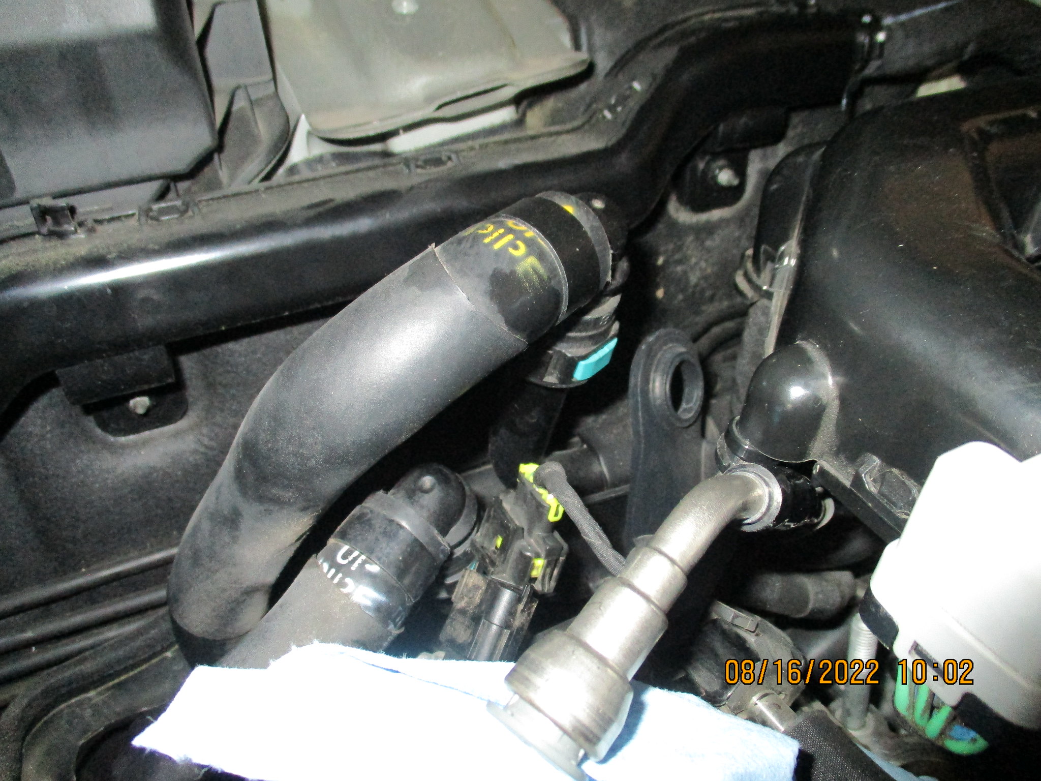

The heater hoses in the rear of the engine. Easy to pull also with quick connectors. However, they could be problem if they dump coolant in an open engine like in my case.

@carguy75 , what impact wrench is that you were using in the picture above? I might have to look for one of those.
