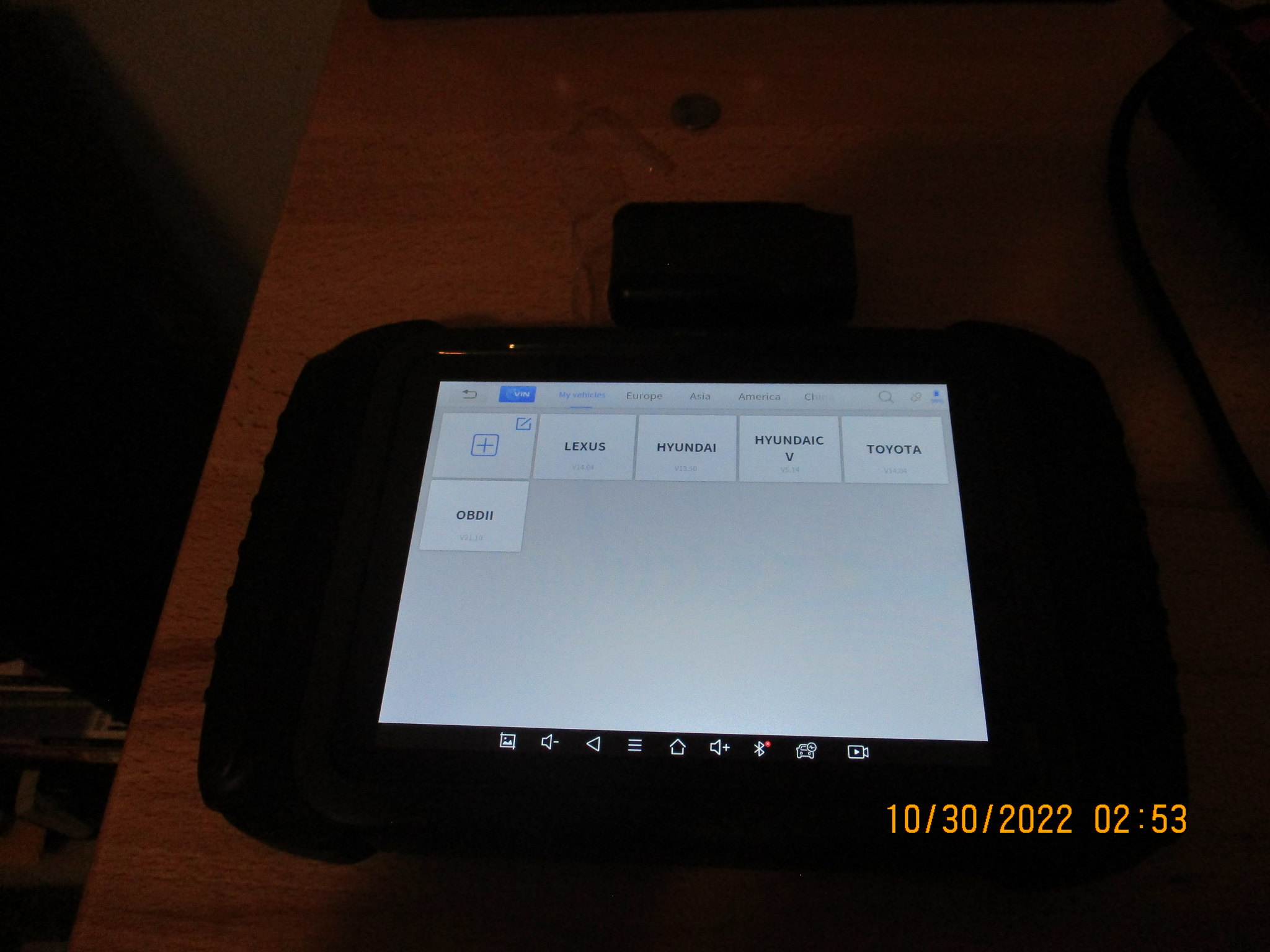

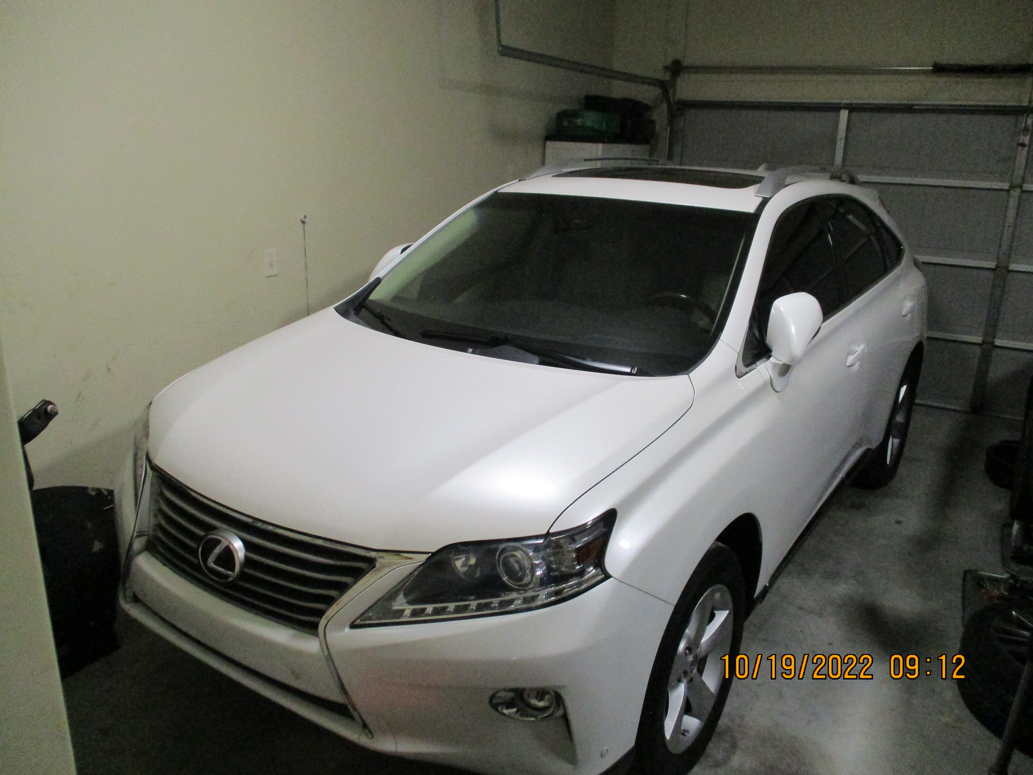

I had to put this project on hold to do some maintenance(fluid changes) on my recently acquired 2015 Lexus RX350 AWD that replaced my old 2006 Cadillac Escalade AWD. I also purchased a XTOOL brand D8 scan tool that does key programming, ABS bleeding, and module calibrations like parking sensors and electric steering angle to work on newer cars like the 2015 Lexus and the 2015 Genesis.
I gave up on trying to use Chinese knockoff scan tool software and just purchased a professional grade scan tool that does it all for all makes.

My new back up ride until I get the Genesis back on the road.
I was thinking about the D7 to save some coin - I hear that they do the same things but the D8 is faster & has a better interface.
The D8 is a great scan tool. I used it on my 2015 Lexus and it does seems to be able to do any DIY function I may need like ABS brake bleeding and replacing a control module here and there. It is overkill for someone who do not work on cars often, but with newer cars you need a scan tool like a D7 or D8 since major components like electric steering racks and blind-spot monitoring systems may need calibration and sometimes special coding to be added to the main ECU.
I have not used the D8 on my 2015 Genesis yet due to the battery being removed out the car charging while I am working on it, but it does list Hyundai an supported make.
