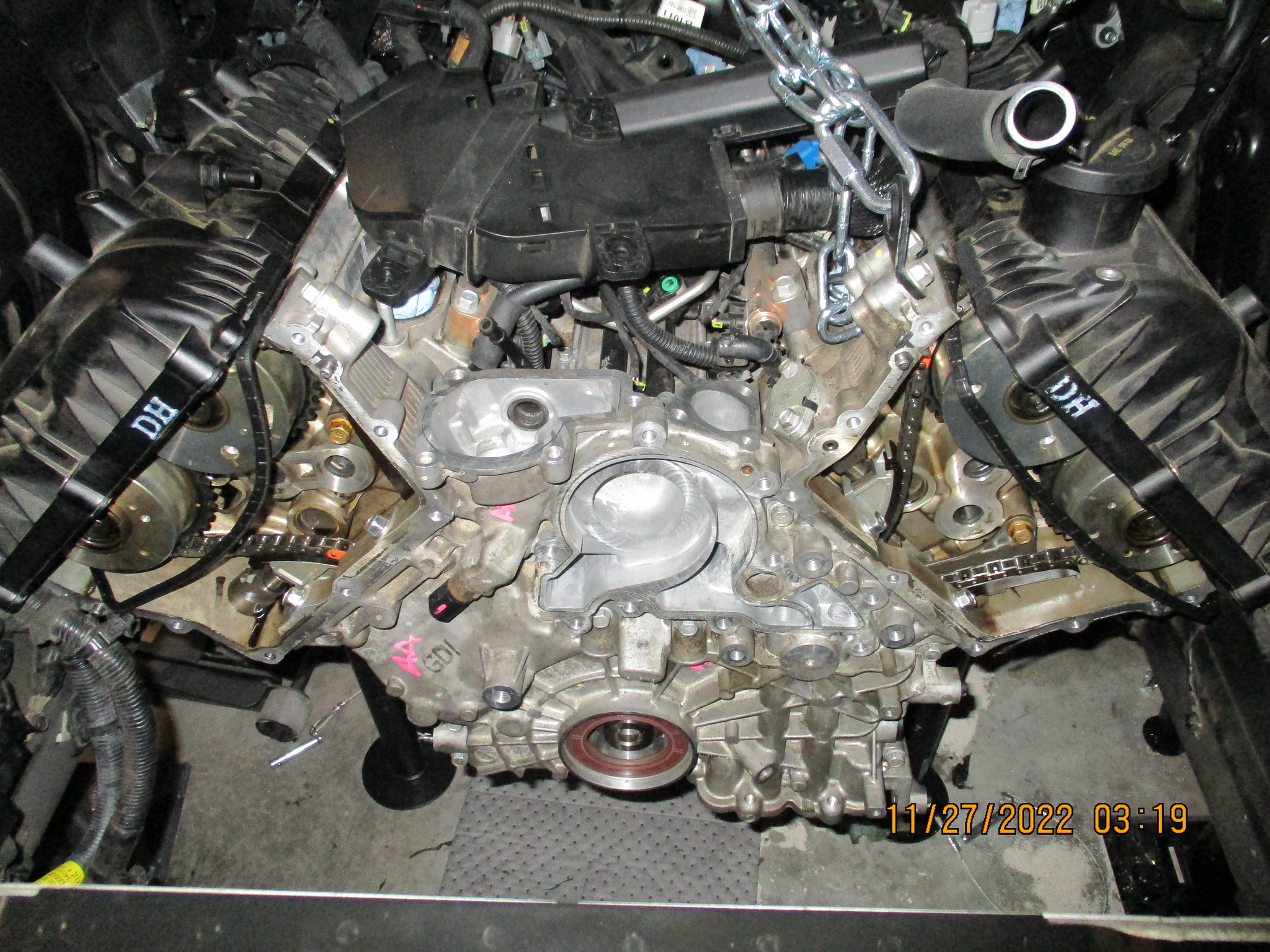

I finally installed the used lower timing cover. I tried to wait for a new lower timing cover to stop being on back-order, but it seems like it will be on back order until January 2023 from what my local Hyundai dealer part department clerk told me. The part department clerk wants me to pay $700 up-front and wait for the part to be shipped in January 2023. If the part comes damaged; then I will have to wait until another part becomes available.
So I just installed the used lower timing cover from a 5.0 Equus I ordered off Ebay and will just trade in the Genesis when it is road ready. I used Permatex Ultra black RTV and new seals(crank and rubber gaskets). I would post more pics and detailed information, but it do not seem that many members on this forum will ever repair their own 5.0 engine to go through the effort.
The lower timing cover installed. Next will be the upper and lower oil pan install.

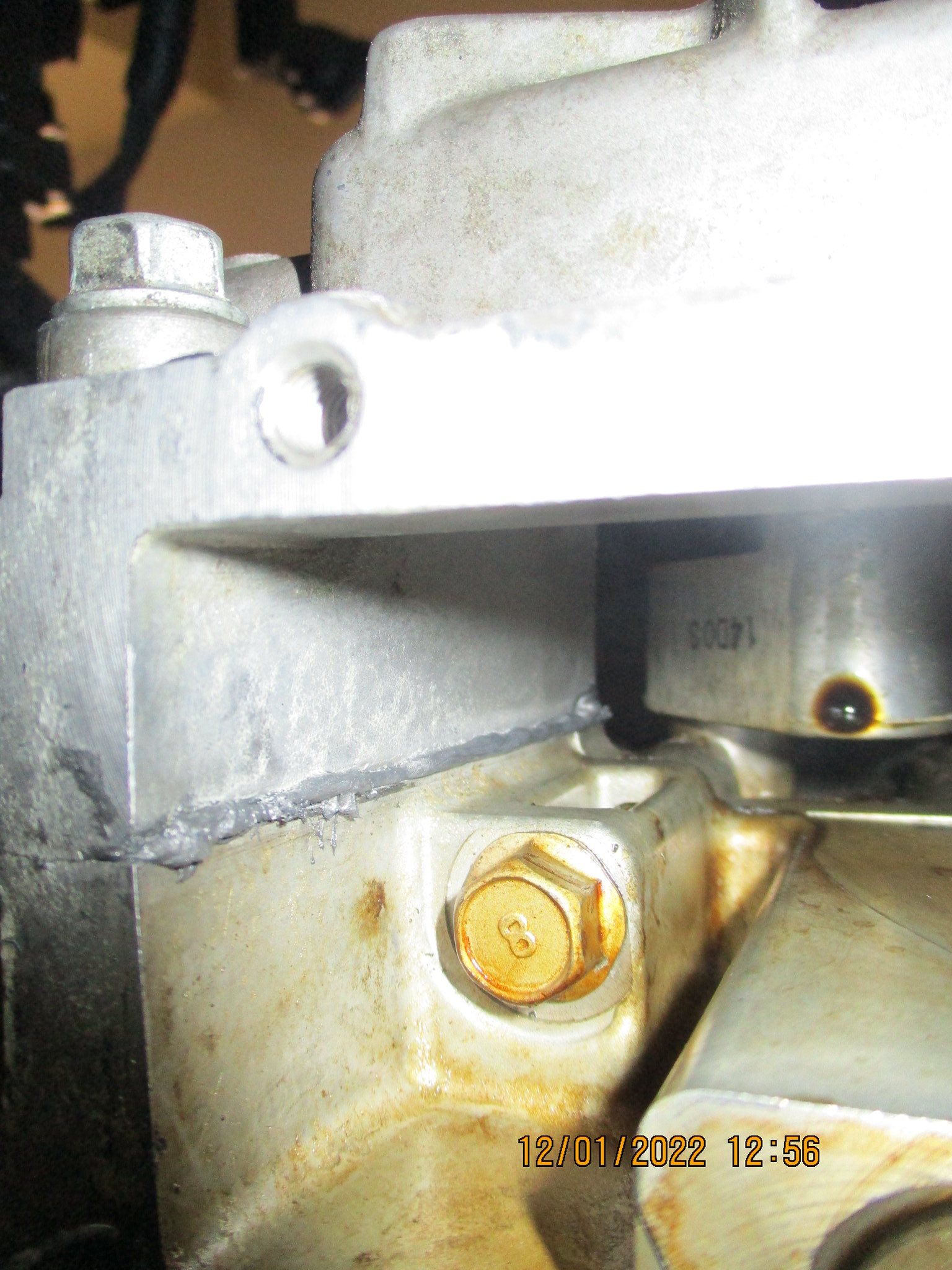

I forgot to show how a proper RTV bead should look when applying it to the timing cover. You should apply an 2-3mm bead of on RTV to inside edge of the timing cover and around the center bolt holes.
The RTV should be visible on the inside where the cover meets the engine block for a good seal, but not so much that it drips and hangs.
Here is the RTV seal I made that is similar to the OEM application. The timing cover is sealed up nicely. I will scrap away some of the excess, but overall a good solid bead line.
