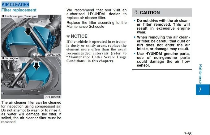

Read the caution note below. Use of non-genuine parts could damage the air flow sensor. This could be his issue as he has noted that he installed K&N filters. Anyone else install K&N filters and have no issues?
I dont want to believe that increased air flow with increased filtration would be an issue. BUT with that said that is exactly what it seems like. Had an 05 stang that I change induction on and had to retune ECM however it was more than just the filter. Ive used K&N on just about everything Ive owned for the last 10 years or so. Still waiting on dealer to call with an update.
the MAF can be a tricky culprit.... a lesson i have learned on other cars. especially given the complexity of the electronics in these cars.

It's not increased filtration, it's less filtration, which is why I won't run one. But, it'd be easy enough to switch back to a paper filter and see if the problem goes away.
You could be right, however they are ISO 5011 tested and certified. Maybe this standard is not good enough for these complicated cars.?
Could be the oiled filter fouling the MAF. Just sayin'
I have a friend who is an exotic car mechanic who advised me against using any oil soaked filtration system such as K&N as the oil can adversely affect the MAF.
May not be your problem but it is something to consider. Good luck!
ISO is nothing more than a set standardization of procedures and testing. This does not mean it is safe to run or tested to be safe to run in the real world
Good luck and be sure to update us once you hear back from the dealer mth
