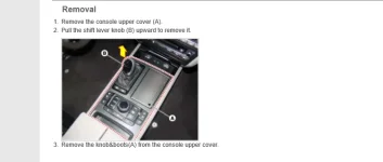

The manual say to just pull up on the handle and it should come off, just do it already lolol.

I think your right it probably will pop out once its seated. looks like it should fit, come on just one hard tug lol.
If I remember right from pulling my center console out on my '15 the gear knob and boot are connected. You have to pull the boot edges up *first* and then pull straight up on the knob to remove it all. And that boot trim is t.i.g.h.t., use a plastic putty knife to help get it out. If you do choose to just pull up on the knob, be very careful or you might "liberate" it from the boot.
