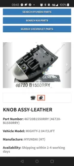

Bud, you might want to do some basic research before trying to tell me I'm wrong. As I said, I was looking into this for HOURS.
The 2 part numbers with 1550 in it is JUST the cap, as you can see here in this pic and in literally any Hyundai parts website where it shows that it is just the cap.Screenshot_20210920-094313.webp
The 2 part numbers with 1050 are the full shift knob, but both of them are for the SBW version only.

And here is the other 1550 part number, also just the cap.
