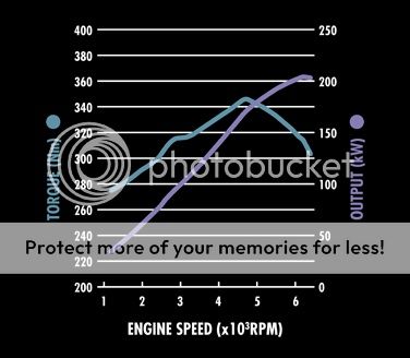

But one thing I know is that Hyundai's motors are known to be quite 'peaky' in that they developed peak torque at high RPMs, normally above 5000rpm and their torque curve isn't very flat. I guess that also counts.
Here is the torque curve of the 2GR-FE Camry V6 engine;
I am not sure how you could indicate that hyundai motors are peaky and then post the dyno curve you did of the Camry V6 engine... That is the definition of peaky.. That TQ curve looks like a mountain top..
A flat TQ curve would be one that makes >90% of peak TQ across the RPM band IMO..
