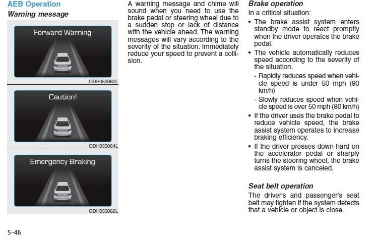

The AEB system is a multi step system. Read below. I have also noticed that at a point between the "Caution" warning and just before the "Emergency Braking" kicks in, the seat belts tighten up. Nice to know they thought of that as well. It also tightens up the passenger seat belts as well. This kicks in based on just how close you are to the vehicle in front of you.

Thanks for posting the appropriate manual pages as I learned something new. I thought the sensor was behind the large flat plate on the front grill however it is a camera up behind the rear view mirror which controls the system. This is the area that needs to be kept relatively clean if you do not want error messages.

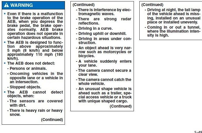

Where in that manual posting above does it say the camera is behind the rear view mirror? Did I miss that in those posted pages?
Read the warning part on the second page and you will conclude it is a camera.
It's actually uses both - a camera and radar data which are combined to sense and activate the AEB system.
